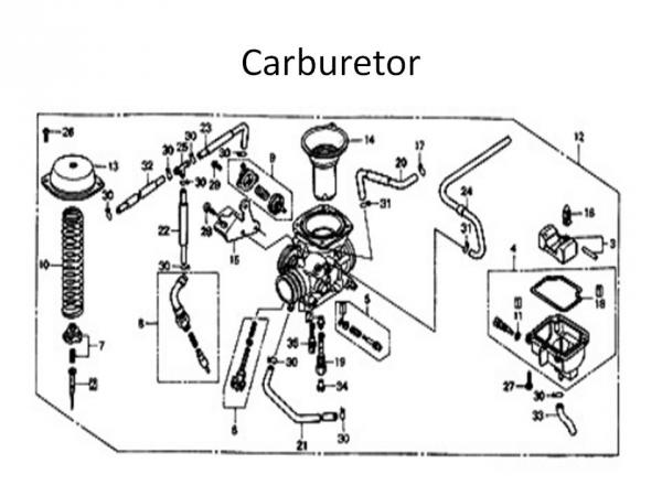

hi phantom knights
could any of you guys please post a couple of pics, ref the location of vac air tubes on the carb. After a top end engine overhaul, iam just left with these to reconnect. and yes i did take some photos before disconnecting, however the wife(bless her) cleaned out the "junk" on her iphone, probably had something to do with the oily prints all over the phone!. if anyones interested my engine had done 77k and i was really impressed at the top end condition.
because it was in bits i changed the cam chain and tensioner but original chain was only 2mm longer than new, and tensioner looked pretty good too. some fine engine!
thanks
stevet
See if this helps

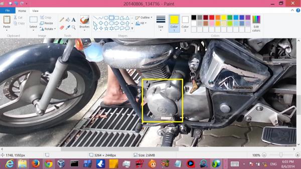

Hi All,
Recently my TA200 is hard to start up and with a weird sound when starting, anything happen to it..? please help.http://www.youtube.com/watch?v=DGX0x3SfEKU&feature=youtu.be
Open your throttle slightly and try starting again see if it's a fuel mixture issue first. No major problem electrically since u can crank

Also, can't hear clearly the cranking sound, can record again? Trying to hear whether starter motor got engage the crankshaft or not.
If got motor spinning and got engage u will hear "ehik ehik ehik" usual sound, If not if u hear only a whirling turning sound that means starter clutch nv engage crankshaft. If u hear clicking instead meaning starter motor electrically never activate.

Thanks brother shawfly for the comment...actually my bike finally cannot start at all with only the ehik ehik sound (Engine not running any more) i park my bike at Mcrichie reservoir park, so today i call a mobile repair he is an uncle (quite supported by forumer call ah hua) to help me check, he change the battery and a solid gear type metal (i can't remember what it called in english)...the damage is SGD300....TT..i have to save my meal for half month since this is just early of august....is the price reasonable..??
He got give u back the broken parts and did u take photo? Not sure what solid gear u are referring to but 300sgd is steep.. Not sure the starter clutch assembly is that expensive even though..
Hi Brother,
He open the cover and change a piece of solid metal inside which is hollow and got gear inside, location please refer to the image..part.jpgpart.jpg
