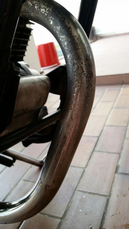

another problem im working on is the rust on my pipe, tried to get it off via few methods:
aluminium foil with water (makes the pipe smooth but doesn't remove rust)
aerosol (no effect for me)
turtle wax rust removal (doest work as well)
anyone has tackled this problem before?[ATTACH=CONFIG]320829[/ATTACH]

Rust on pipe... try Coca Cola and aluminium foil. :) or tooth brush. and lots patience :D
If there is only surface rust u do ok i think. My have scratches and rust is deep too so i just did what i could not to make hole.
I used coca cola to remove rust from muffler and sand paper but that was prepartion to seal holes in muffler so didnt worry about scratching Chrome.
Im thinking about removing all that rust with sand paper and make layer of epoxy heat sealant and smooth it out and spray with heat resistance "chrome" paint. Wont be so shinny but will not look rusted ;)
