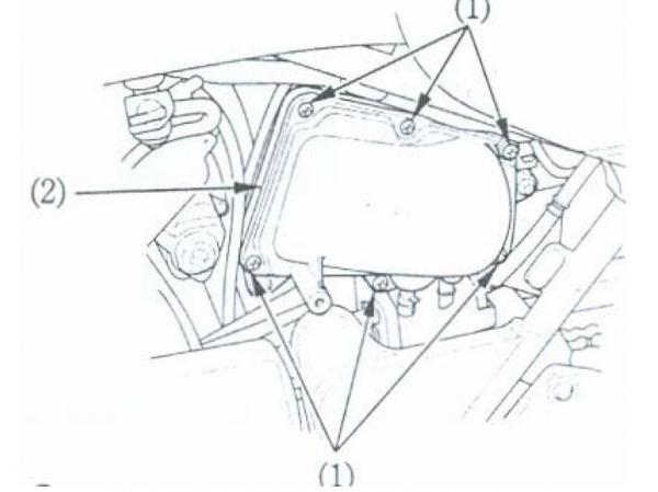

air.jpgyesterday while cleaning my bike, i noticed that there is this small reservior of oil at the air filter compartment. Could fellow riders give a clue what this oil reservior is used for? also besides the oil reservior, there is this small tube also. Anyone can advise what is this?
  ming76 said:
[ATTACH=CONFIG]267283[/ATTACH]yesterday while cleaning my bike, i noticed that there is this small reservior of oil at the air filter compartment. Could fellow riders give a clue what this oil reservior is used for? also besides the oil reservior, there is this small tube also. Anyone can advise what is this?
this is eo...
for environmental reason...the eo expelled from your engine due to high operating pressure..
in older bikes..the expelled eo is directly to the atmosphere...
clean it up ..nothing serious..check your eo level. overfilled eo will have this conditions..resulting in a poorer performance all round..as well as dirty air filter.
