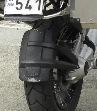

Yes you are right, the picture is belong to GS1200 and im looking for similar mud guard it used for super4. I saw someone uon super4 with similar mud guard thus hope some guys out there can help :)
