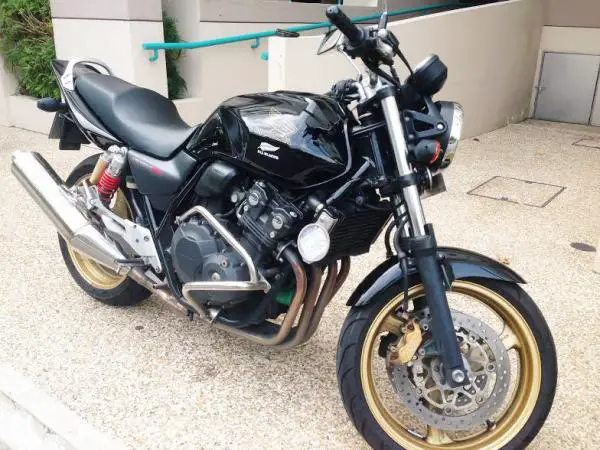

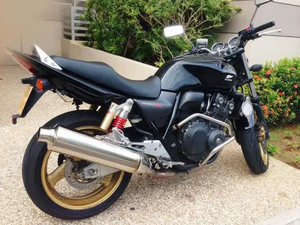

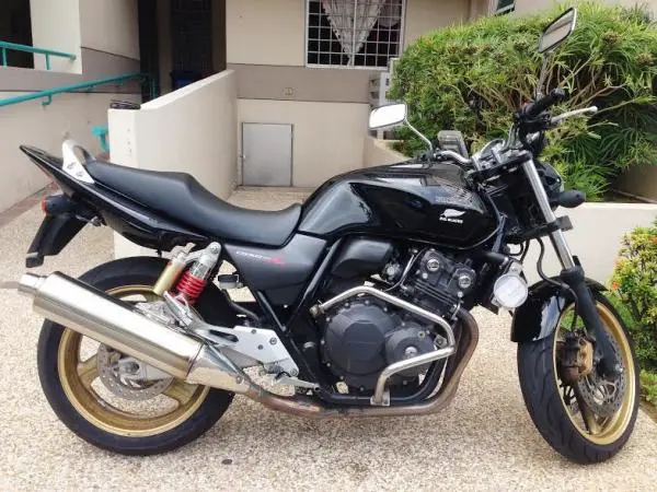

2011 apr, black revo, 36000km, never drop and never go beyond 110kph, tires 6mths old
all stock and excellent condition, owner upgrading
sgd12,800 sms 90107008, serious buyers pls
