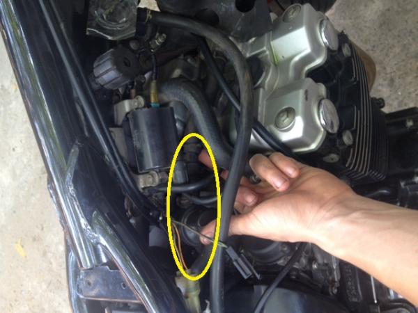

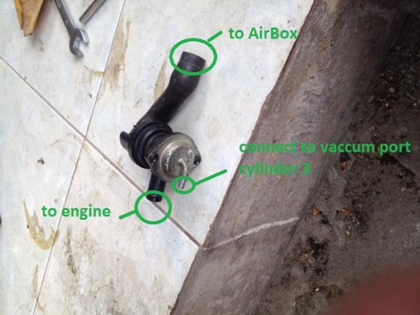

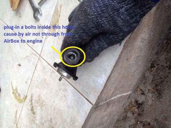

- I'm from Vietnam. I buy Honda CB400 vtect3 date 2005 last year (2015). Once time, while I service my bike, by accident I dectect problem on engine as figure bellow:
[ATTACH=CONFIG]335794[/ATTACH]
- I don't know how this problem damage to engine. I don't understand, what is the function of that part?
- I am going to remove this bolts from that horse. Should do I?
- Please advise me to resolve this problem.
