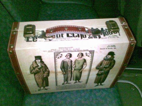

Below is the new top box for my Phantom. Yes, its wooden :D
