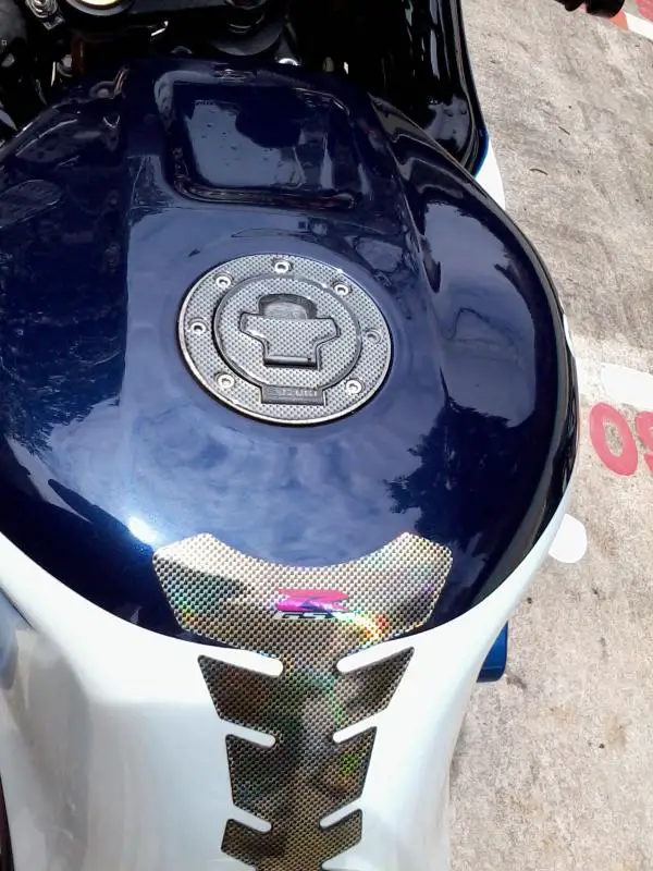

Btw, I did a mesh mod :D Love it? hate it?
Yeah and some cosmetic stickers.
[ATTACH=CONFIG]264695[/ATTACH]
[ATTACH=CONFIG]264696[/ATTACH]
Nope bro it's illegal... Btw nice mash and nice tank pad...

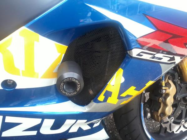

Btw bros, where to get frame slider? I'm looking for one which doesn't require cuts on the fairings...
Mine is drilled to the fairing. This was from motorworld.
It works anyway. Good insurance.
Dragstar 400 classic & Zx6r
