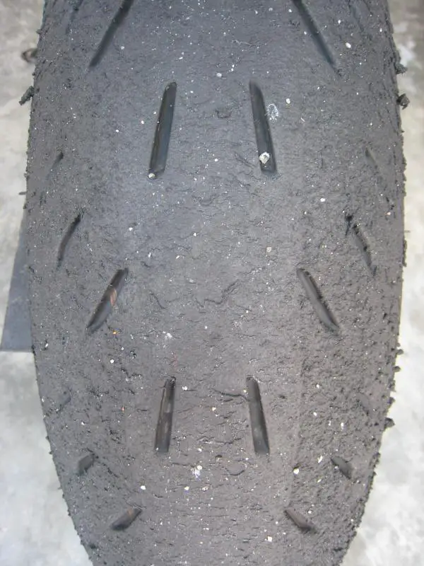

To the experts out there....I see some bikes' rear tyres like got "burnt" marks..it's like flakes esp on the sides...how does this happen??looks quite cool tho..
it's the burnt tyre marks after track day..
something like this??
[ATTACH=CONFIG]218398[/ATTACH]
ya bro but the ones that i see is not as severe as the one in ur pic. What is see is those no the shoulders only. Anyway what causes this? hard acceleration, cornering, braking?

It was caused by the shearing and grip from the tracks from accceleration mainly..
This was so severe as it's taken straight after coming into pit..
Those you see on the road was like this too..
I have a pic of it, will post this evening..

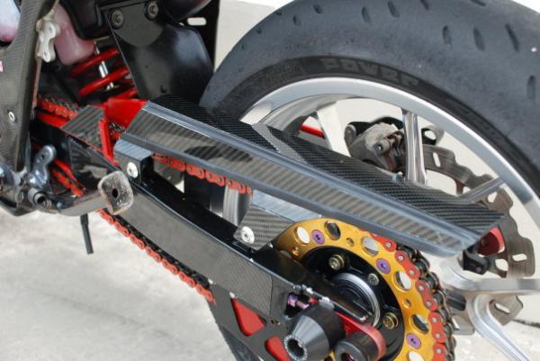

this tyre was a few weeks after PG session.. looks less messy..
