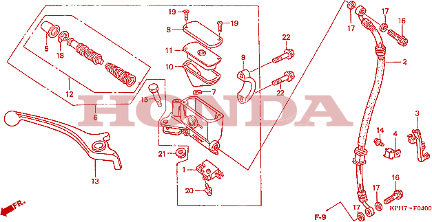

I might need a new brake pump for my Wave I. Dun mind after market but not modding Aprilia/Brembo/Braking master pump please.
Wat happened is that my master pump is not operating smoothly, and is very stiff unlike the rest. A throughout bleeding and changing of brake fluid helps, but the smoothness last a mere 2 weeks. This stiffness is not helping me at all with my braking, and it's a problem since day 1 for me.
Need advises on my options.

Originally posted by IdiotiClown@February 17, 2007 10:55 pm
think u can jus repair e spring inside e pump..dun think there is a need to change e pump.. jus my 2cent
You meant to say there's a repair kit for Wave master brake pump? If that's so, it will be wonderful.
Pls update :thumb:
It's not a repair kit.
I dunno what's the actual name though.
But if u see the attachment i gave u, it's part no 12.
U need the entire thing which consists of No 5, No 18 and the 2 other unlisted parts(Spring).
Also get part No 10. It's a diaphragm i think. Change that also.
Ok got the name liao.
No 12 is called Master Cylinder Set and
the original part number should be 45530-471-831
Part 5 is called BOOT COMP (45504-410-003)
Part 18 is called CIRCLIP (90651-MA5-671)
Hope this helps.
Let me know if u need anything else.
Cheers !
Hope this helps.
Cheers !
