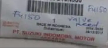

PAIR is Pulsed-secondary AIR-injection System
2nd valve reed is called VALVE ASSY 2ND KIT REED
This one is to trap all dirt air with bad emission into our environment
You can change this small piece by itself separately
You will see the worn out is black color means Mo2, Co2 all bad gas trapped here
This will also block fresh air enter combustion chamber therefore you will have pop pop sound when you release throttle
Just remember to change every 30,000km

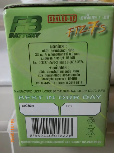

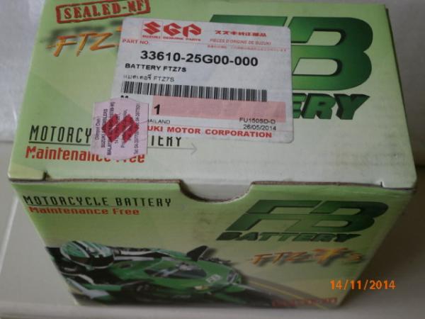

FB battery made in Thailand Suzuki SC JB original belang R
14/11/2014 meter 16km
FTZ7S
RM110
make sure fix correct battery cause it must be sleeping position approved.

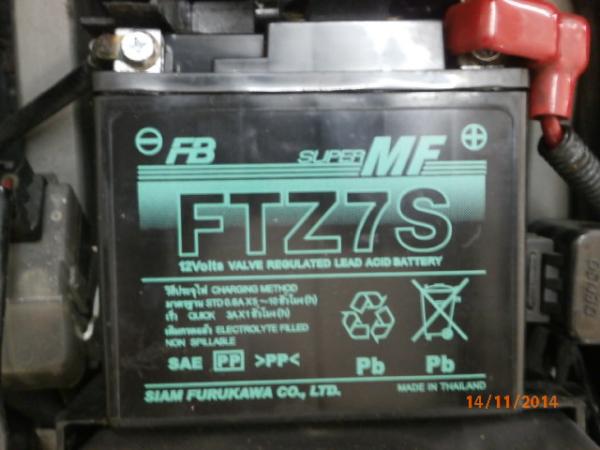

Now my battery capacity is super small at 3.5AH. It cost me $58. No choice but to use till it weakens then change to correct type for my bike. :slapforehead:

Change back to 7AH battery as the 3.5AH battery cannot make it. Cost me RM110. Cut the wrap the seat RM40. Carb servicing RM17.

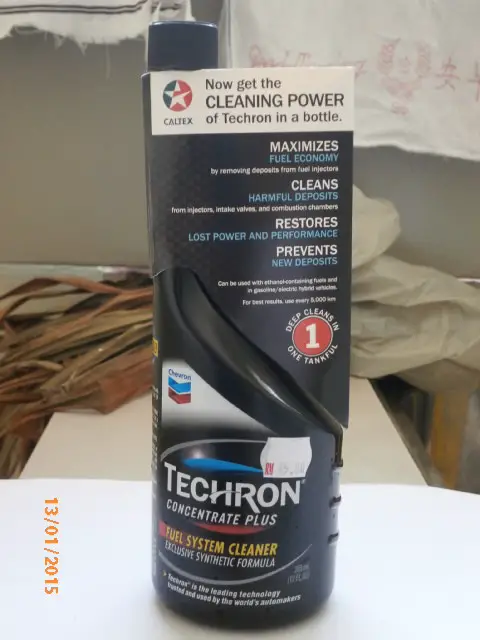

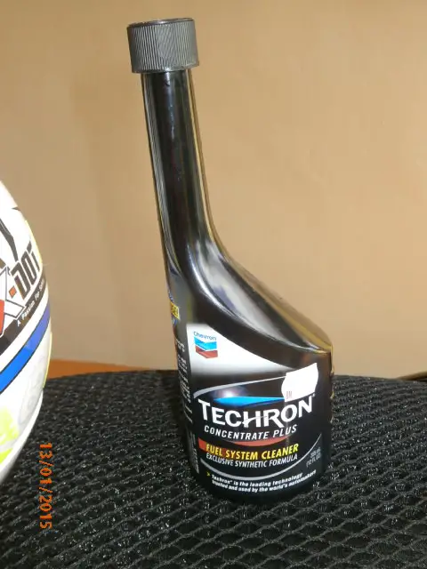

using ron 97 Caltex techron
today poured in techron concentrate plus
to clean the 9 yrs old carburetor and combustion chamber DOHC
