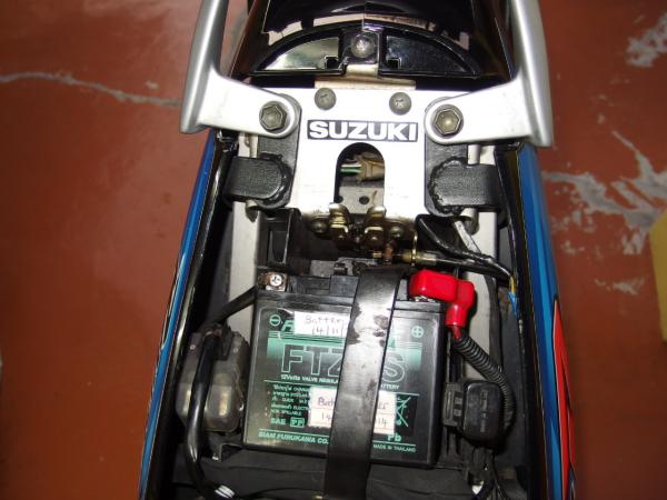

Change my starter relay and now it is back to good use. Nothing mch to repair. Will fix back the cowling soon.

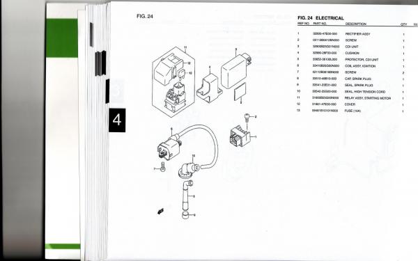

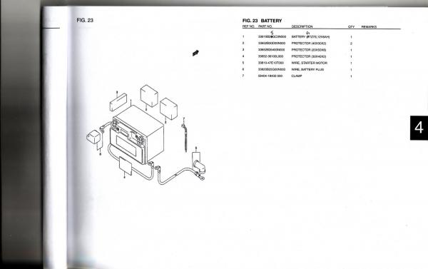

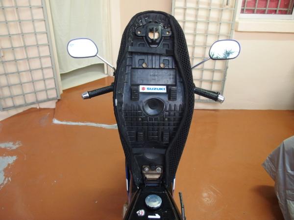

Actually starter relay can be bought from Suzuki Setia. Just no more stock that day I went there. Since already in JB no choice but to ask the regular motor shop to get non original. Cost me RM68 for the relay.
Relay is just beside the battery under the seat. It has cover wit 2 fuses. The motor shop I usually went is the next row of shops at Kang Soon spare parts shop. I can just buy parts and let them charge labour.

I think Suzuki Tropika will be cheaper. The starter don't work. So you can check by using 2 wires to jump the connections direct. If the starter motor can start then it is the relay problem.

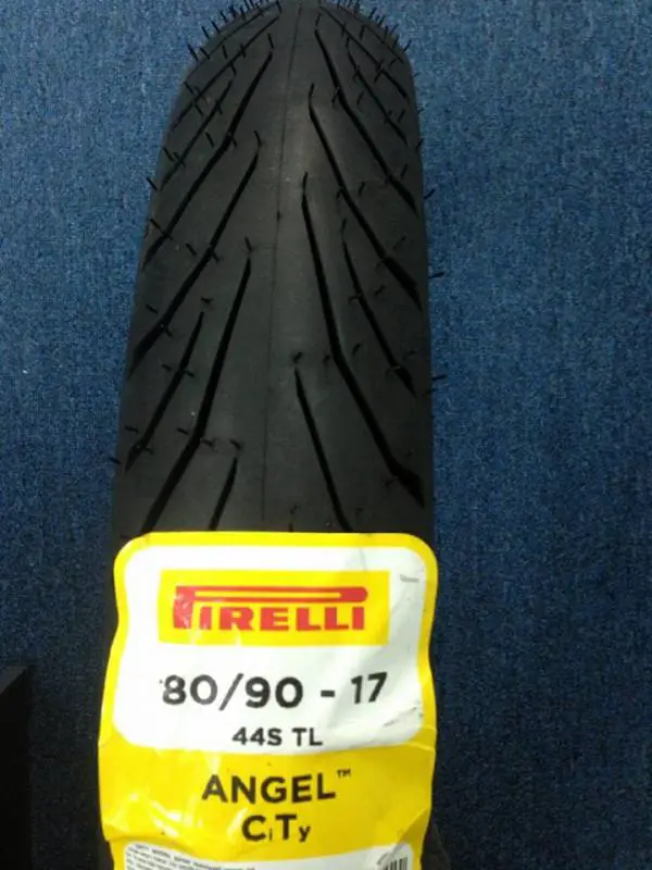

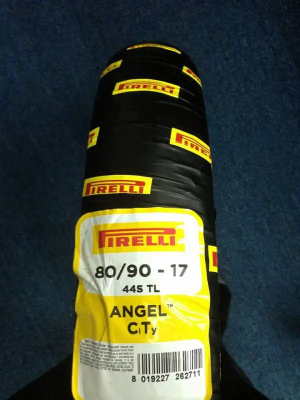

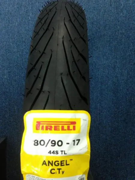

i have ordered Pirelli tires front/ rear for cub kia / cub chai
i will get on Monday 9 November
moving from michelin pilot street to pirelli angel ct

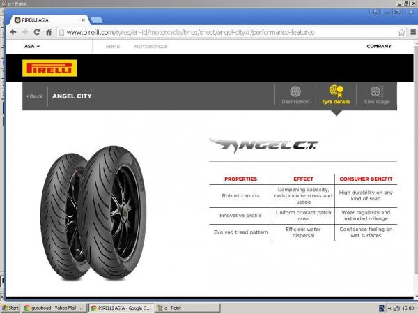

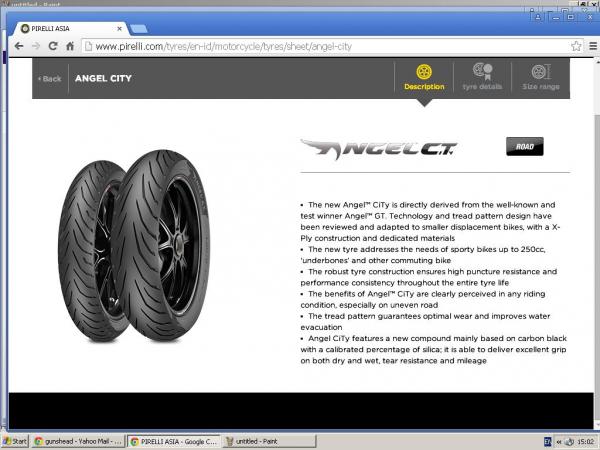

see pirelli technical and infos
http://www.bikehk.com/report/2015/r6582/?page=3&
I buy in Setia Indah spare part shop
less then RM85 each tires
contact 019-7864608 to buy from his shop
attached

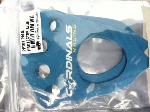

palm rest
i suggest long trip riders buy this
i ordered from KL
bank-in maybank account
RM40 + poslaju RM6
They send courier from KL
I choose light blue color

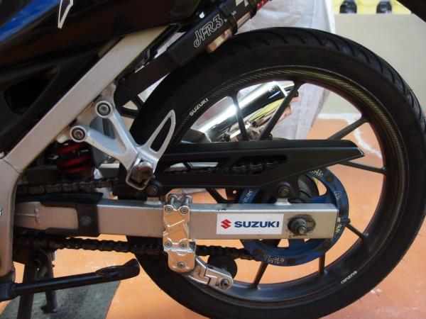

10,520km
3/12/15
service
change engine oil shell R4
tighten chain sprocket
that's all

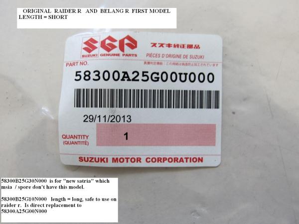

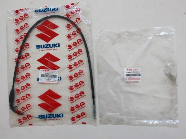

1. adjust/tighten handle bar to avoid tuck tuck noise hit bonggol. After tightening it feels so good.
2. checked swingarm - ok
3. checked all cables in right position - ok

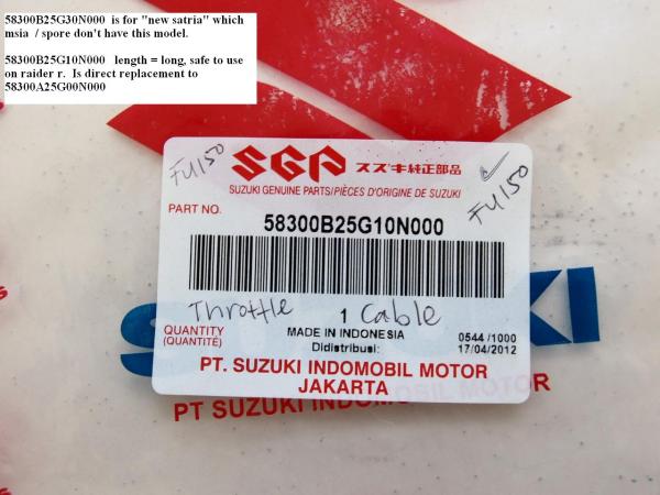

4. change cable throttle. First time doing since year Feb 2006 bought bike. Used original Raider R length = short.
RM11.70
Labour charge Rm15

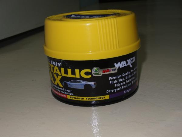

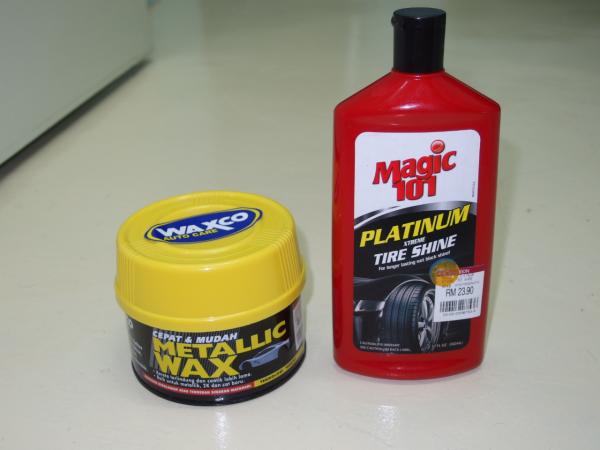

changed engine oil
shell R4 + oil filter 1180ml
wash and wax bike
my favorite wax

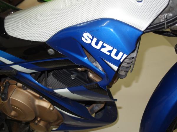

19 feb 2016
6pm
met accident on causeway jb towards woodlands
very sad day
raining

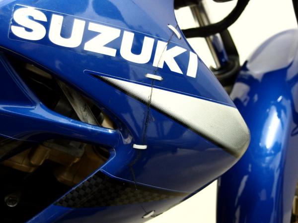

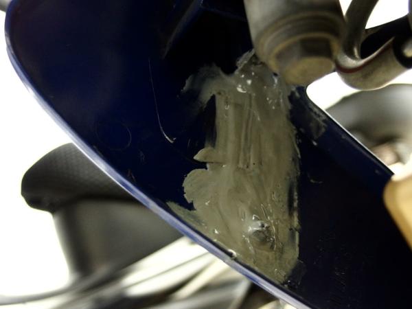

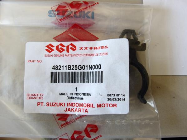

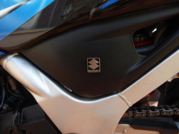

repaired
broken clip shield cowling leg 48211B25G01N - RM3.50

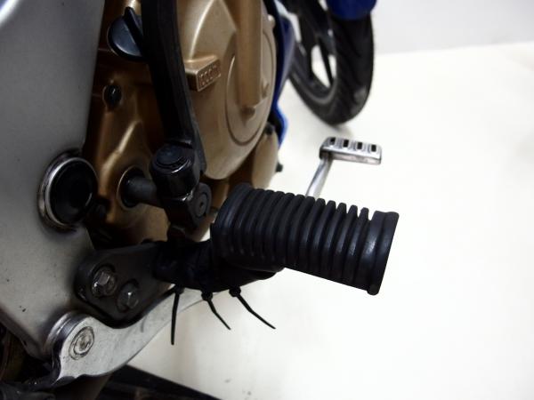

broken rhs fairing - liquid glue then fibre A+B mix glue then cable tight
loose handle - tighten
rhs footrest slanted - adjusted
Edited by gunshead
