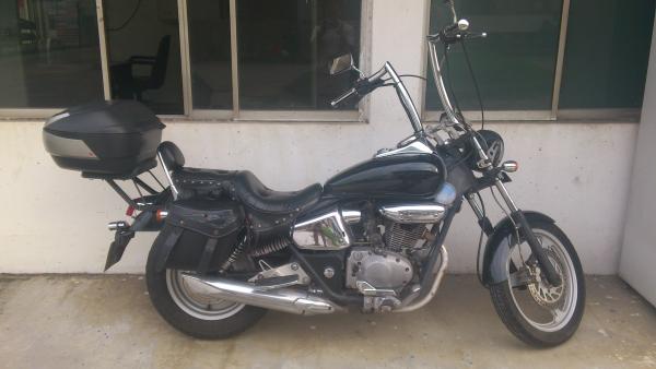

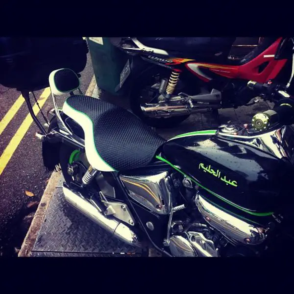

Wow guys. All the photos make me drool. I plan to get a Phantom after passing my TP next week. Anyone can be kind soul to actually help me inspect and give me advices? Haha can treat you makan and kopi.
http://img.tapatalk.com/d/13/03/16/3y9a2a2a.jpg
http://img.tapatalk.com/d/13/03/16/bu6ehety.jpg
http://img.tapatalk.com/d/13/03/16/dany8yha.jpg
