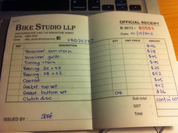

I wonder whats wrong with my phantom TA200.
Is like not power even when i open more throttle.
Went bike shop and mech told me there might be a few reasons which i not sure if i should do a mega servicing or not.
http://i191.photobucket.com/albums/z87/stevenlai78/honda_z7no2572.gif

looks like its only part of the bill, can see at the bottom "continued on 505XX". Yours looks like full overhaul. The labour will be the biggest amount. How much did they charge for labour?
Just a curious question, how come your bike is FBD plate only then do a full overhaul liao? Is there any major problem with the engine?

i suspect owner retain plate
But his photo showed a Fire Edition Phantom, so might coincide with the plate ah. Unless it was another bike. Anw TS do reply at least we know smth yeah
