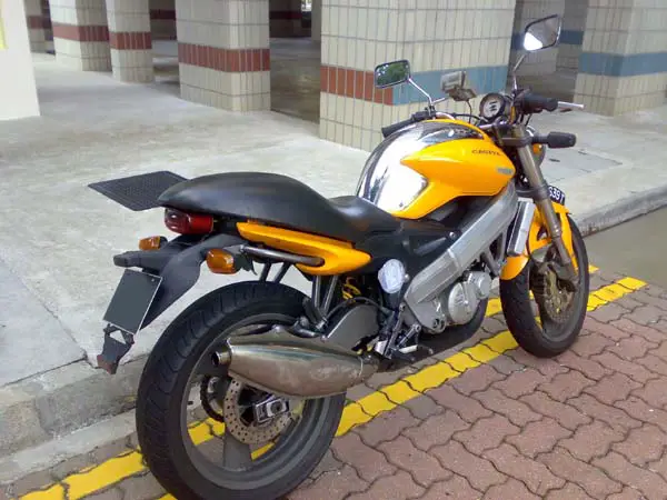

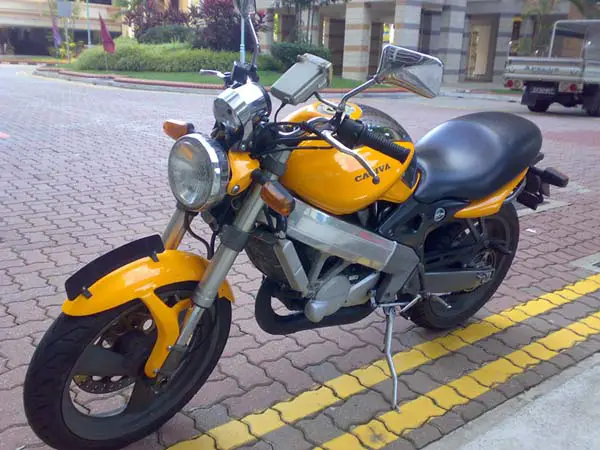

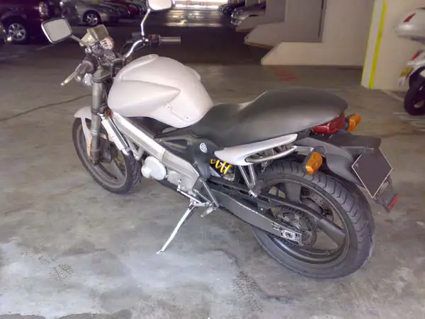

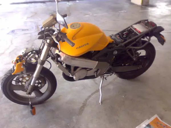

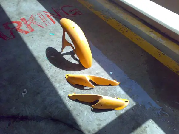

Just to share some pics of my DIY respray.

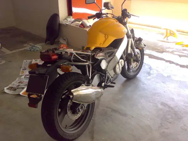

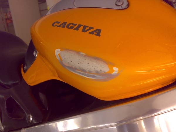

Previous owner did not maintain the paint work well, lots of scratch and also dropped the bike b4 causing the right side of the tank to be scrapped off.
So i gave it a go at trying to diy.
pics 1 & 2, b4 anything was done.

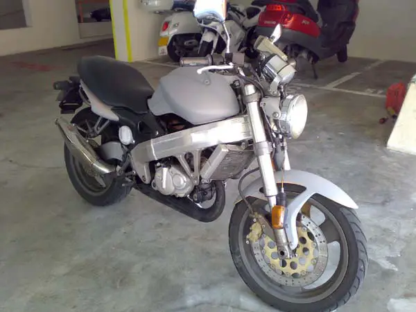

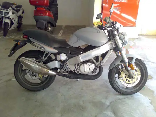

pic 3, patched up the right side of the tank using expoy putty

Wow...how long did it take ya to sand the whole tank off?
How about paint drying time?

wat confem sanding took one whole day one...unless got sander machine..
wait for primet to fully cure should tke max one day...
ANGELZ INC for info click on arrow^
http://extreme-art.nl/images/SKULL-ON-FIRE2.gif

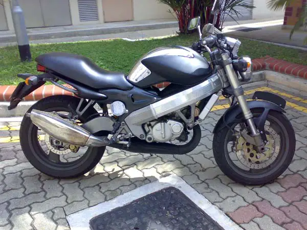

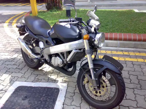

The putty work of the tank took a total of 3 days to get the tank shape back.
The sanding took 2 days, 1 day for the tank only and 1 day for the other parts.
Primer left to dry 1 day then sand again to smooth the surface for painting.
Total of 1 week plus for the whole project.

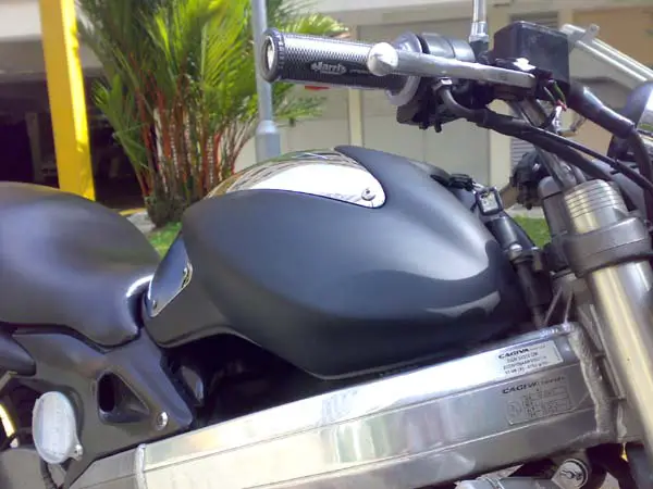

By the way color resprayed is matt black.
did you use spray paint? if so did you lacquer or clear the bugger?
cause cannot see the shine?
Yup, I used RJ London brand spraypaint.
I did lacquer it but with dull lacquer instead of the usual gloss lacquer.
So far after a week and been in the rain, the paint is still good.
Anyway here's a breakdown of the total cost of the whole job.
1 x can of primer - $4
5 x can of dull black - $22.5 ($4.5 each)
2 x can of dull lacquer - $9 ($4.5 each)
some sand papers - (less than $3)
epoxy putty - around $6
Total cost is only around $45.:thumb:
As compared to around $280 :sweat: quotes by a few shops.

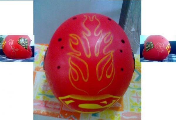

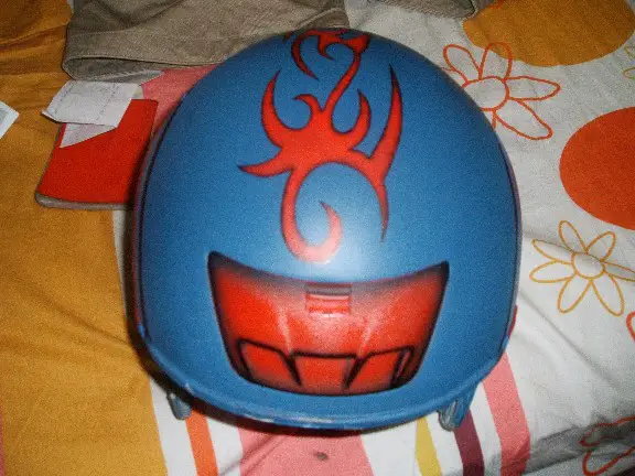

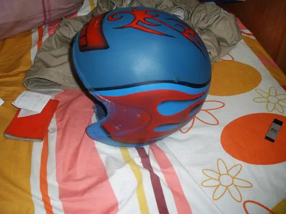

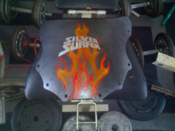

hope this TS doesnt mind i post my project here. attached are my 1st two attemps at airbrushing.

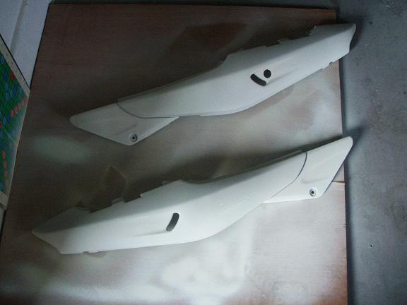

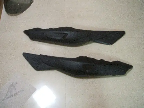

tail of KR fairing.
sand in down, with 240,
then with sponge down with rudding compound..
after primer, sand down with 1000 grit...
spray black. not yet sand down.
all my jobs are done this way.

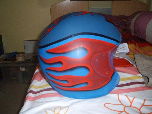

by the way, this is my 1st attempt using automotive paint,spray gun and airbrush. hope to share with you guys my ups and down.
yah... in know...paint colour sucks big time...
i felt like S*H*I*T..
somemore doing for a fren..hope he doesnt see it on this thread.
so i sanded the whole helmet down. you can see the next post.
