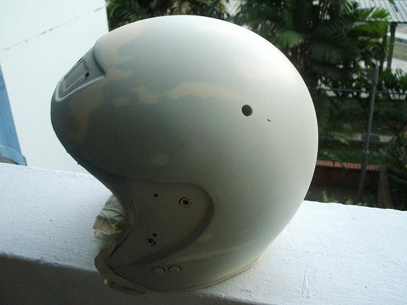

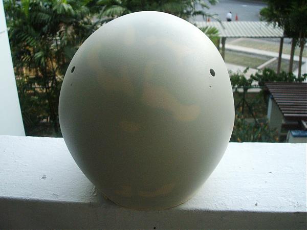

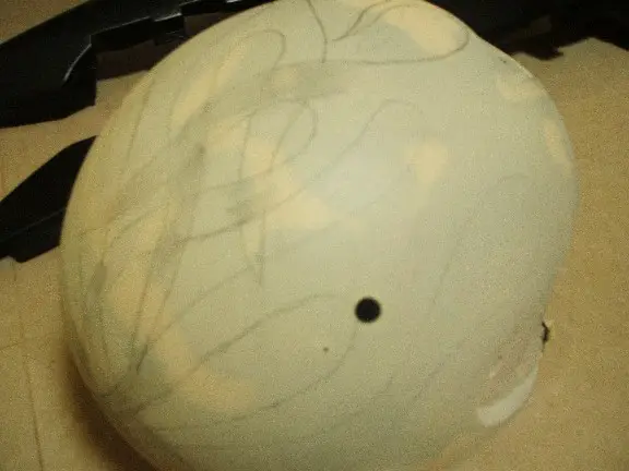

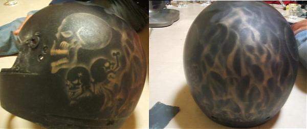

you can see i sanded down to core. thru the primer you can see i none of the old paint was left, if not the the old colours and design will pop thru. the last is a preliminary sketch of a design i have in mind. still in a fiz what base colour to use.

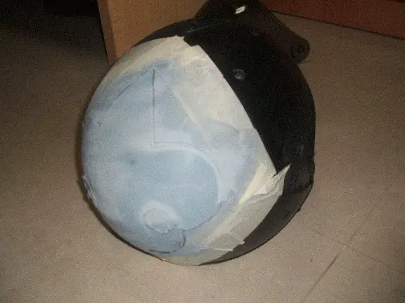

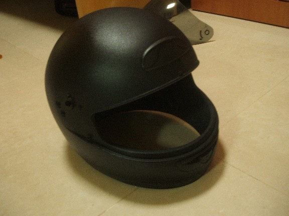

two other helmets im working on. one is an old school full face for my self. and the other is a nova helmet for fiancee try to draw a scouts logo.
the reason i do primer on the black is so the other colour can see thru. i predict i will run into alot of trouble doing the design though. stay tuned for project not completed. will upload when done.

I must agree with the saying u pay for what u get. $5/can paint vs $50/can paint.
Nice projects u have there.
Do u have a sanding machine to help with the sanding? Otherwise i salute u for sanding all the way until even the base primer is not there.:sweat:
I would like to experiment with airbrush if i have the chance next time also.
Some questions to ask u, where did u buy the automotive paints, industrial airguns & compressors from and how much do they cost?
I have only have a mini compressor and hobby airbrush which i think would be fine only for detailing works and not big areas of the bike.
Hope we can see more people posting their DIY spray painting works here.

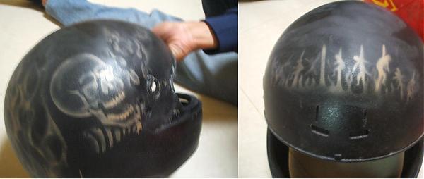

hope this TS doesnt mind i post my project here. attached are my 1st two attemps at airbrushing.
U've done a gd job bro, after seeing ur paint work i mus say u r very detailed, patience and oso skilled enuf to do dat..........:thumb: :cool:

no sander...just plain sweat though i finished sanding down the old design in a matter of 2hours only. this is where i know i can do it. I realise it possible. then to really take the next step.
you can try chin wah paint at balestiar road. http://www.kangaroopaints.com.sg
you must get HVLP gun. got alot of places. if you really interested then PM.
your mini compressor must upgrade liao. your right impossible to do the whole bike. but you can always do helmet.
aiya if you really interested, and ready to spend $600...i will show you the journey.
