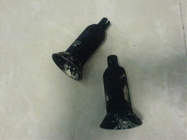

actually taking out the silencer can be DIY-ed, i did mine myself. it's not that tough. there are 3 rivet screws at the end of the exhaust. just use a powerful drill to drill the rivet, den use a plyer to pull the silencer out. if u wana make it even louder, must go to the bikeshop where they cut open the exhaust to remove another metal plate that is inside the exhaust and weld it back i suppose. the silencer looks like this. As for the speed, actually i dont feel much of a difference, but the sound is quite loud as compared to the original one. For inspection, i intend to just slot the silencer back, but not screwing cos the inspection centre is just near my house =)

ahweebbq: thanks for the tip on the exhaust, i just did mine today. sounds a whole lot more throaty man, n the pickup slightly better too. cheers!
