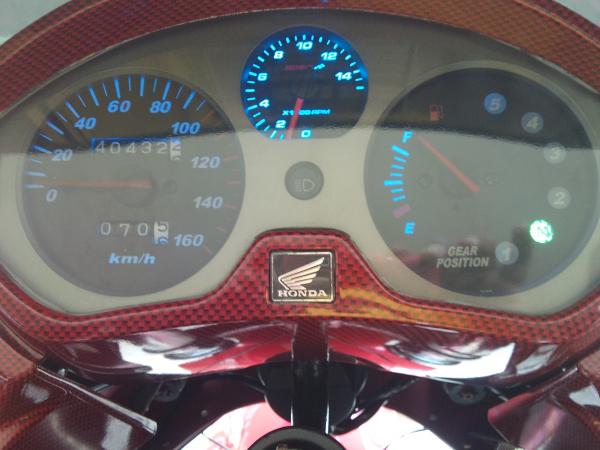

Prepare RM$250 approx S$110 and follow me on our Hawkz Flight and get "RPMed"
Pls note that this is not a cheap meter, Its a original "KOSO" from Taiwan.
comes in 2 dial colours, white and black, both are blue light illum.
So how? I think our friend(Stevoo) who tried to get the meter from HK has fallen into a hole some where without internet
this is the next best thing and cheap too considering the work involved. If interested, we will need to go early cos the job take approximately 1.5hrs.
Actually thought of squeezing a volt meter in there but not enough space.

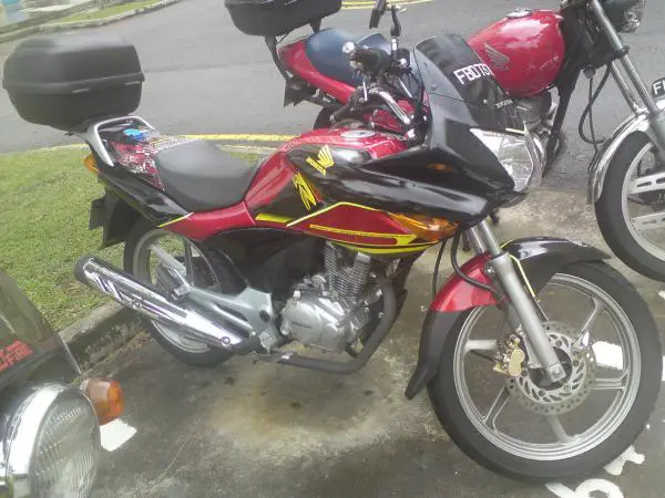

Guys any idea on where I can redo my bike design to its original condition? The paint starting to fade and scratches are getting real ugly. Lol... Some pillions I take keep accidentally scratching the side as they get on my bike...
I've had this:
[ The price we offer is about $350.00 including labour charge and sticker. ] from Replica Spray Painting. [ http://www.replicaspraypainting.com ]
This is the current look for my bike... Planning to restore it to totally original. Paintwork and stickers and all.
I've had this:
Bro, maybe you try to check it at TEO SPRAY (Defu lane).
