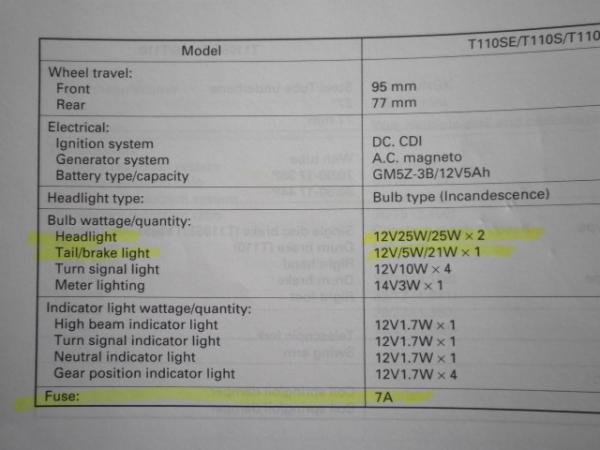

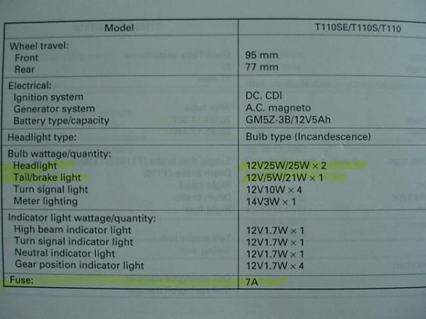

for those u forget about the bike original factory specification for electrical bulb watts
see attached

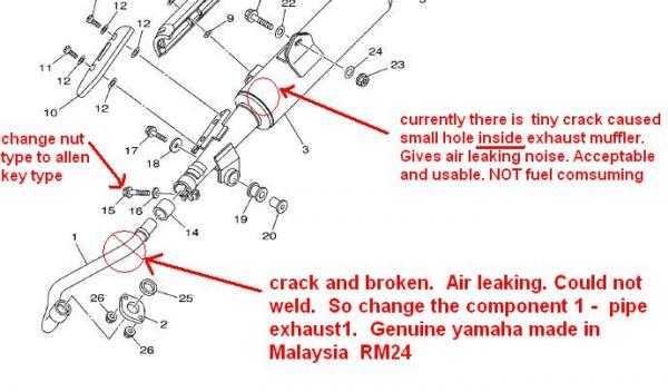

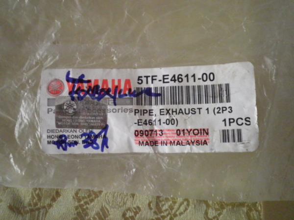

Exhaust crack , air leaking giving loud noise.
5TF-E4611-00 / 2P3-E4611-00 / 5TP-E4611-00
PIPE, EXHAUST 1
HLB price RM24.00
nut type changed to allen key type - longer , bigger and stronger . Tightens from minor air leak.

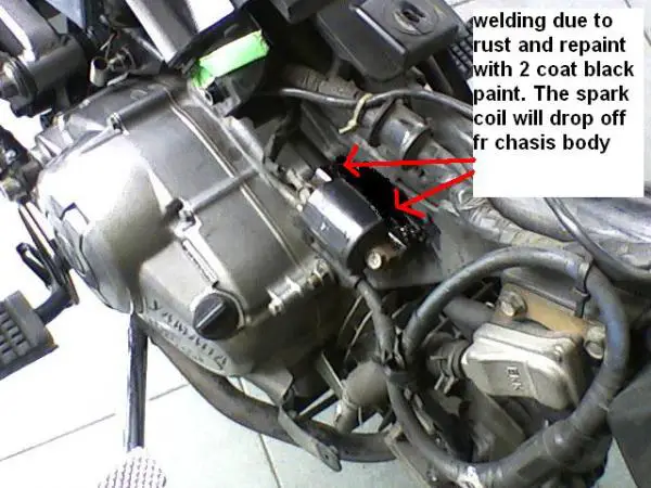

Spark ignition coil bracket rusted. Welding coil bracket to body chassis. Repaint with 2 coat black paint.

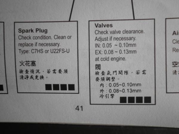

Valve intake & exhaust used gauge measurement clearance.

SEE ATTACHMENT DIAGRAM - WILL ExPLAIN THE ABOVE

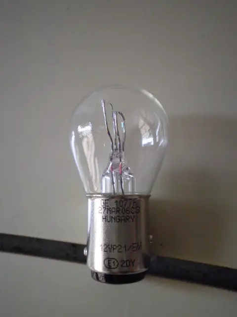

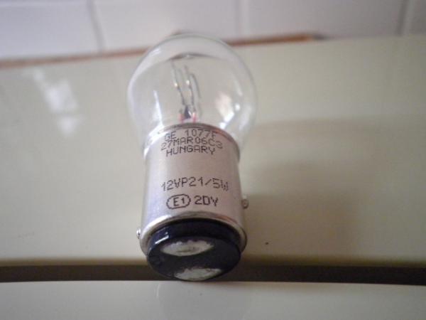

rear bulb
12v/18/5w
RM4
original factory is 12v/21/5w
see bulb attached ;next time use this with longer durable solder

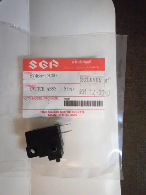

Front brake lever switch spoilt. No rear brake light. Changed switch assy . Used genuine Suzuki made in Thailand.

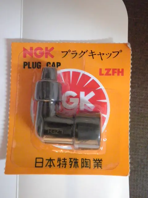

Changed spark plug cap genuine NGK - first time using
Total RM20

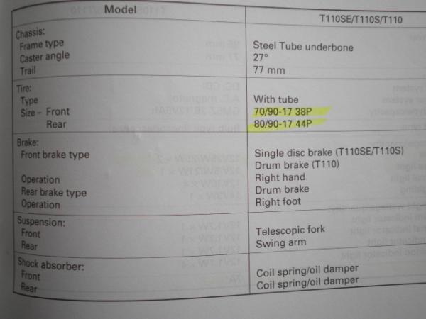

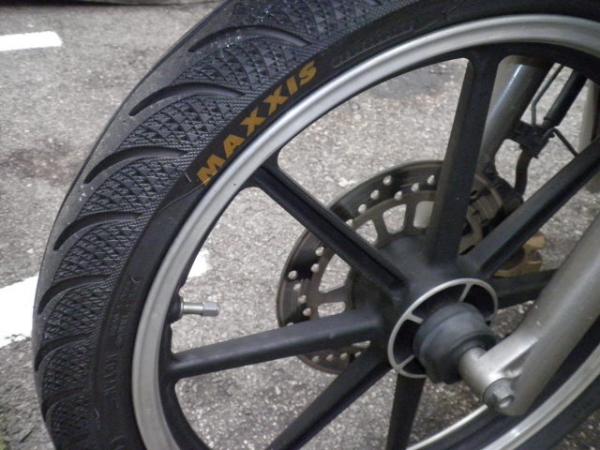

Currently me using front wheel Battlax tire - world superb tire for cub kias
since i am in budget now, i think try change to Maxxis
I saw this in JB
RM75 for front wheel 70/90-17
tubeless
the pattern is unique
diamonds at edges
made in vietnam

4. valve tappet adjustment

Maxxis Diamond tyre front 70/90-17 tubeless made in Vietnam RM87
Shell Rimula X hr3 engine oil 15w-40 RM 14.50
Adjust valve tappet clearance
Adjust chain drive
Labour charge Rm2
This tyre seriously I DON"T recommend. Not good grip on dry road and also slippery on wet road. You can feel the handle bar front shaking due to bad grip.

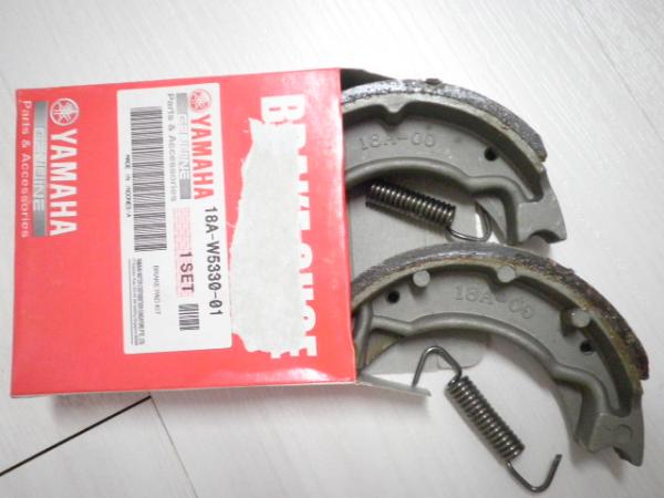

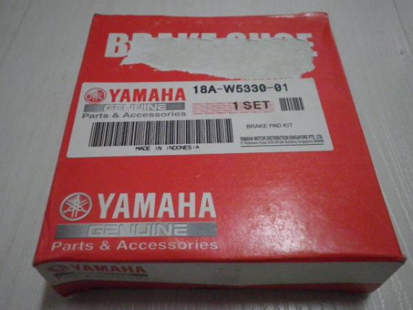

1.Changed brake shoe. Genuine Yamaha made in Indonesia.

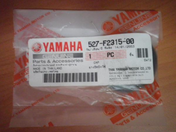

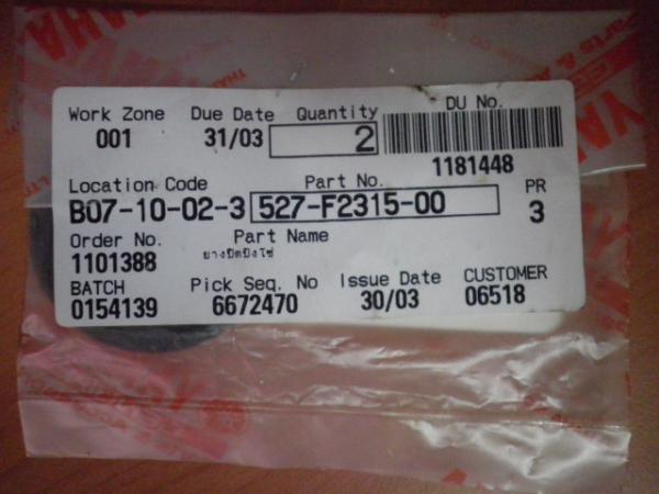

3.put new chain box cap which lost. Genuine Yamaha made in Thailand

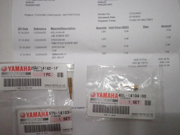

ordered and bought carburator parts
today collected at HL yamaha , paya lebar road

bought genuine brake shoe for yamaha spark Z
made in indonesia yamaha
SGD 8 one box
Good quality and the spring is very long and strong.

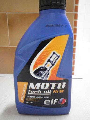

in December gonna change fork oil
bought this ELF 15w viscocity at serangoon road
SGD 7

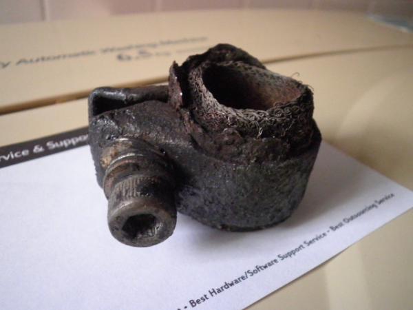

my bike the centre part of exhaust which has gasket broken with holes and cracks
so cut the centre part and rewelding
attached photo of the centre gasket and broken item

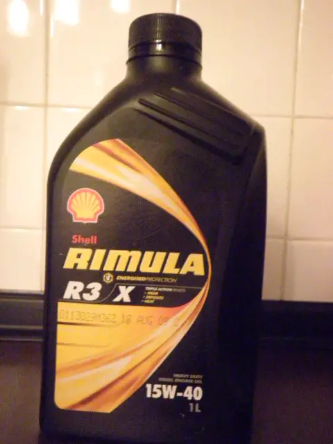

1. welded exhaust pipe RM10
2. changed R3 shell Rimula X engine oil labour RM2

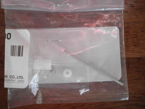

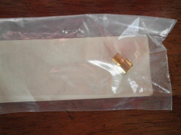

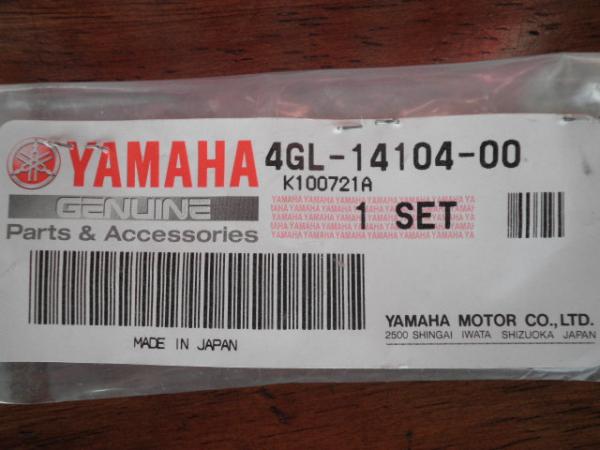

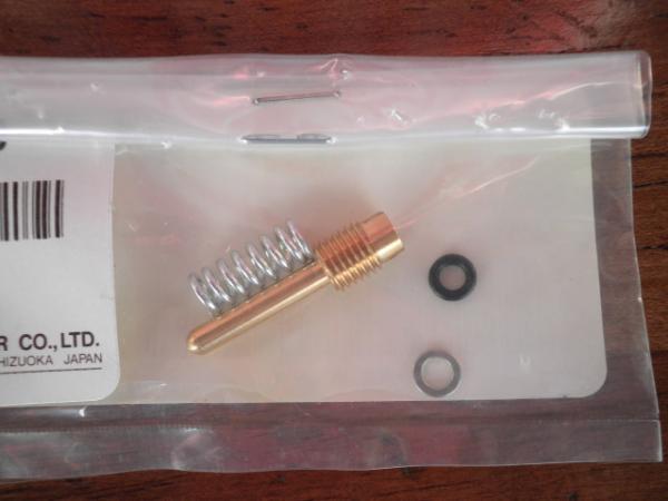

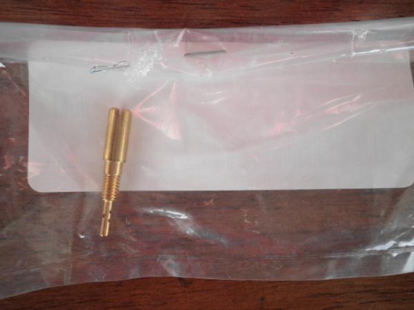

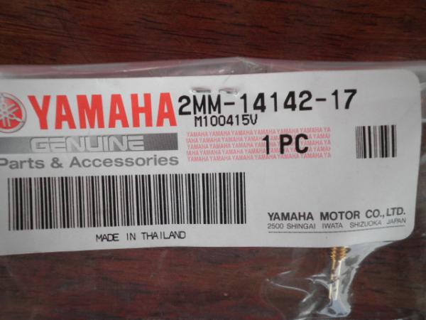

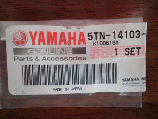

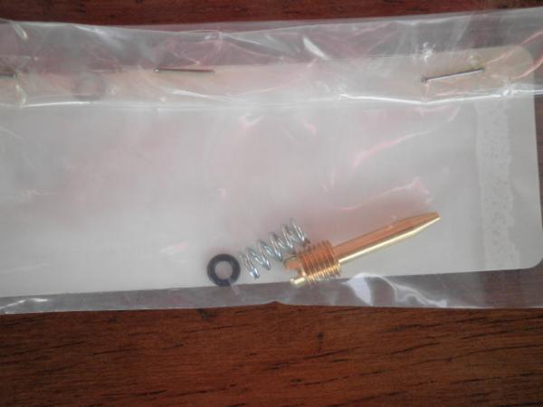

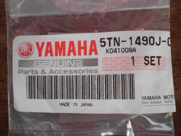

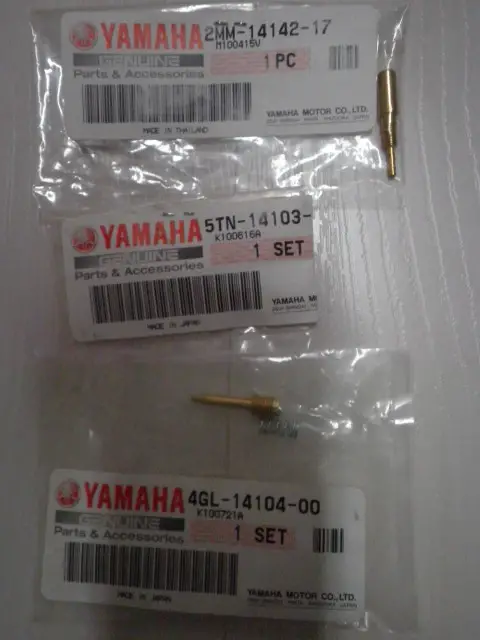

OVERHAUL CARBURETOR WITH CARBURETOR KITS
i. 2MM–14142–17 .JET, PILOT (# 17.5)
ii. 4GL–14104–00 .AIR SCREW SET
iii. 5TN–14103–00 .THROTTLE SCREW SET
iv. 5TN–1490J–00 .NEEDLE SET - throttle slide needle set

Fork oil ELF 15w changed 61cc each fork

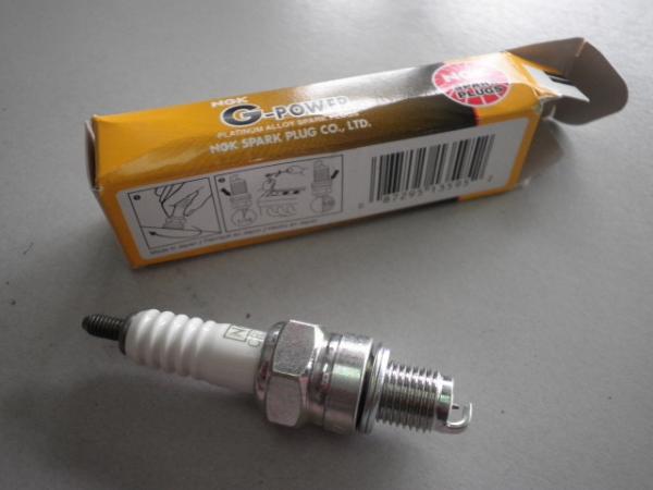

NGK G-Power platinum alloy spark plug

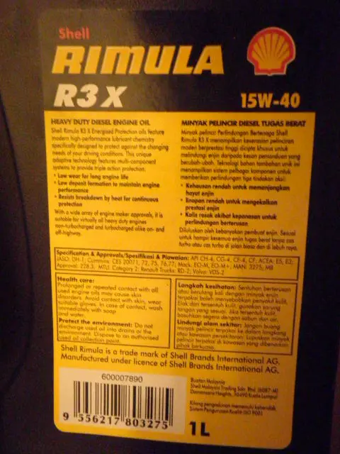

SHELL Rimula X R3 diesel engine oil 800ml

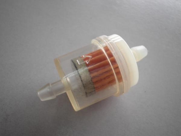

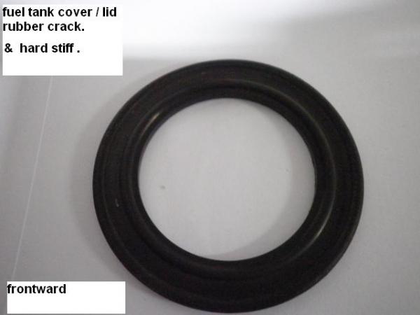

NEWLY FIX FIRST TIME FUEL FILTER
Double stand shaft oil WD-40

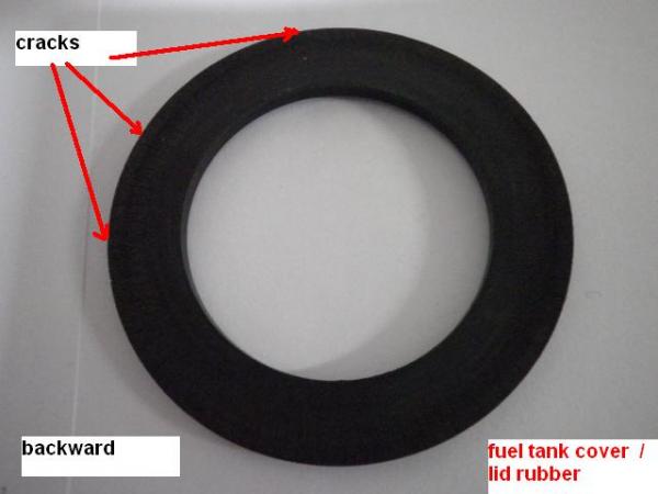

FUEL TANK RUBBER CHANGED TO NEW. OLD WAS STIFF HARD AND SIDE CRACKED

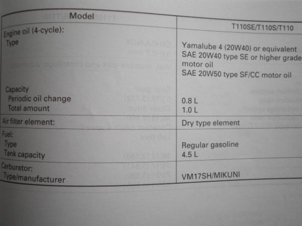

continue parts photo and also for those who forget the critical parts in manual for reference
Thank you very much for your kindness consideration. By God's Grace.
