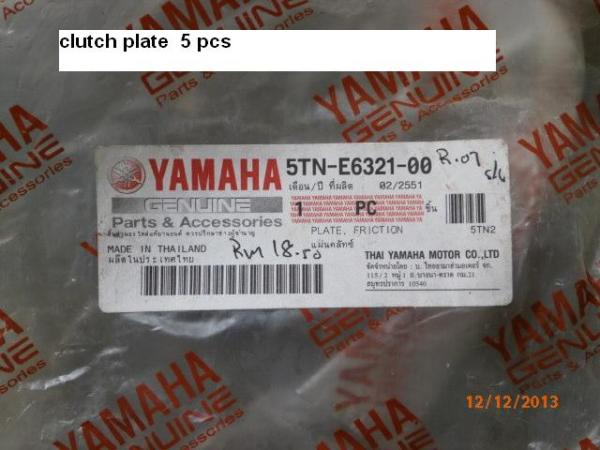

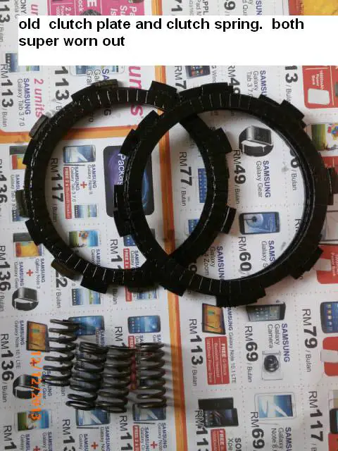

meter 76246 176,246km
11 dec 2013
skudai
changed clutch plate genuine yamaha 5 pcs
each pc RM18
changed 4 clutch spring each RM4
changed FCCI gasket RM4
changed engine oil rimula X R4
adjusted free play TSK throttle cable OK
clean needle jet OK
checked tensioner OK
checked primary driven gear 20% worn out.
Total RM 110
