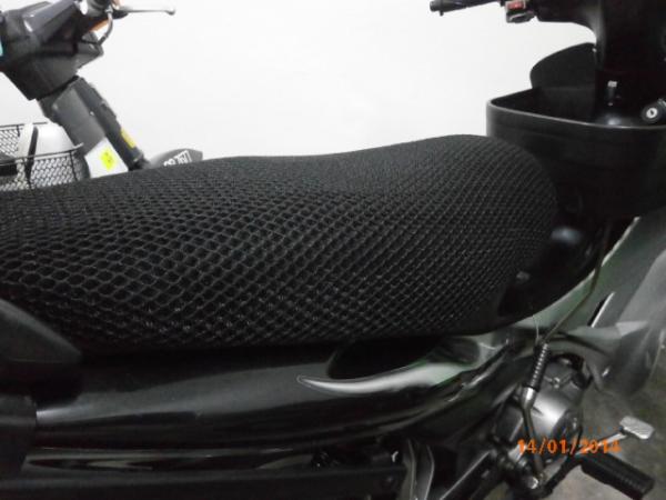

fix
cap kuda
made in vietnam
net seat
RM 20
at singdeca JB town
fantastic air flow
13/1/14

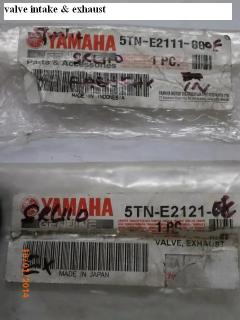

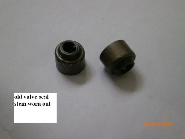

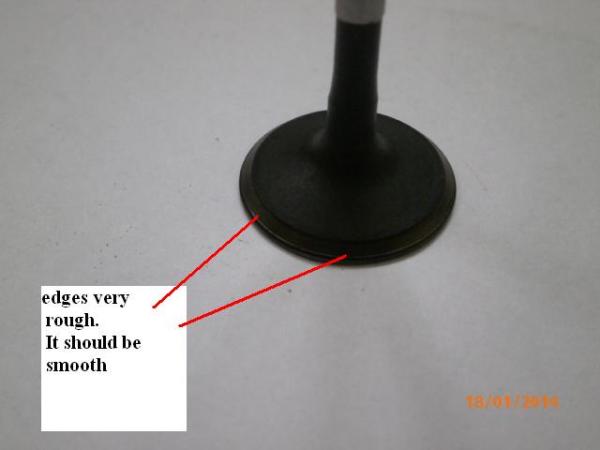

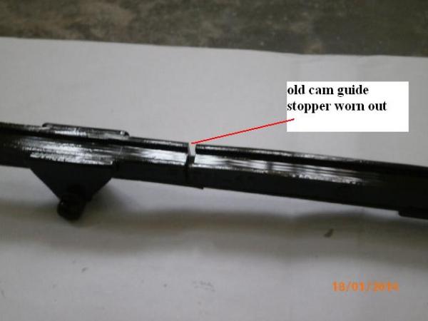

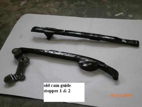

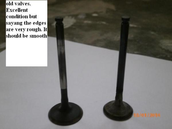

symptom
after riding ......stopping at traffic light or just stopping , notice that idling at Neutral or gear one is high rpm. open /close throttle two times then rpm will drop to normal. This makes petrol high consumption a bit.
Suspect could be valve spring, tensioner, camshaft or carburator parts.
2 days down in shop
changed
cam guide RM42
5TN–E2231–10 GUIDE, STOPPER 1
5TN–E2241–10 GUIDE, STOPPER 2
valve RM56
5TN–E2111–00 VALVE, INTAKE
5TN–E2121–00 VALVE, EXHAUST
valve seal RM17
5TN–E2119–00 SEAL, VALVE STEM

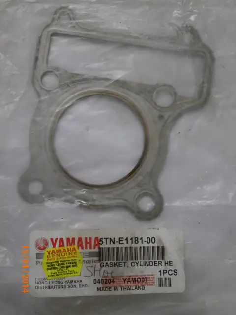

gaskets RM18
5TN–E1181–00 GASKET, CYLINDER HEAD
2 O-RING in upper block cylinder head

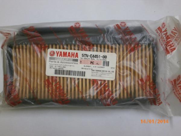

air filter SGD 10
5TP–E4451–00 ELEMENT, AIR CLEANER
NGK G-Power spark plug RM12

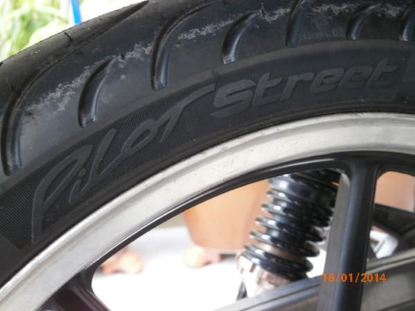

Michelin Pilot Street rear 80/90-17 RM110
Wheel rear tyre nut air valve L type RM5
Fork Oil LUCAS synthetic 10W

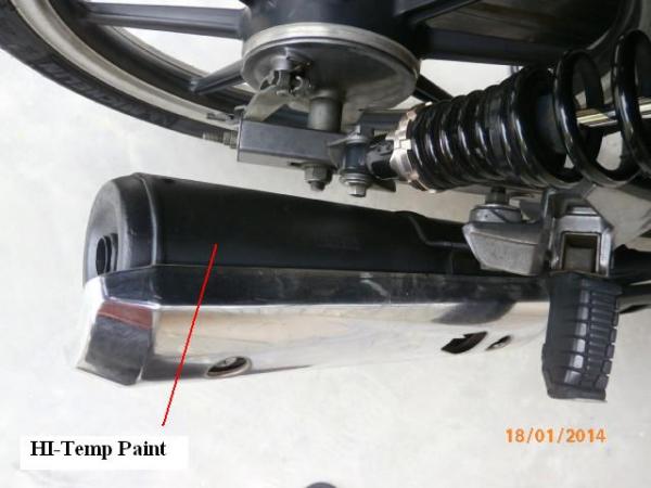

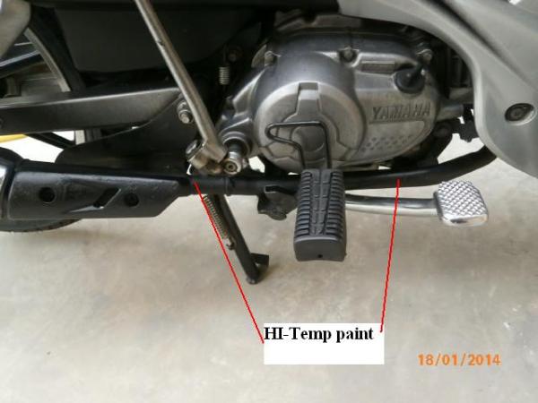

Exhaust spray HI-Temp paint
Engine oil Shell Rimula R4 800ml

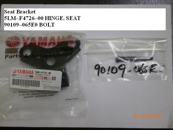

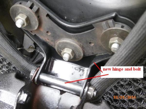

Seat Bracket
5LM–F4726–00 HINGE, SEAT SGD 5
90109–065E0 BOLT SGD 1.50
Labour charge fix items, crem valve and repair RM43

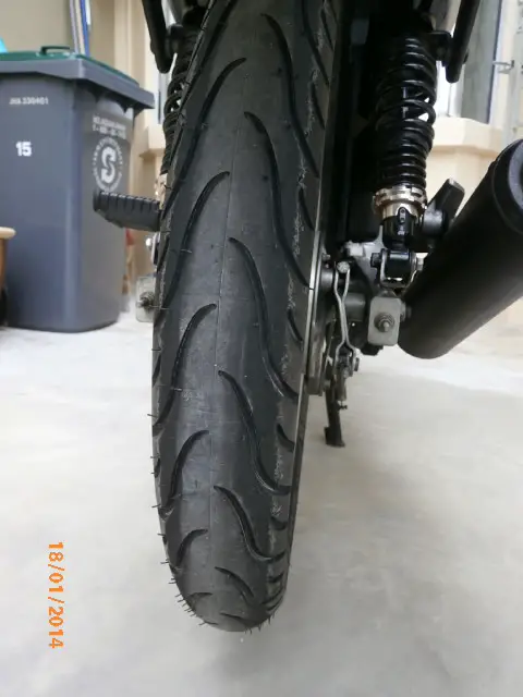

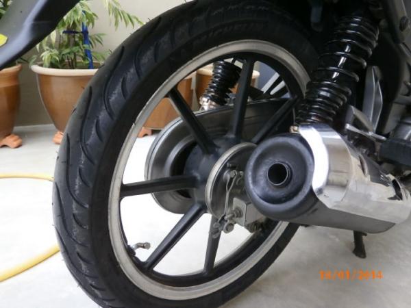

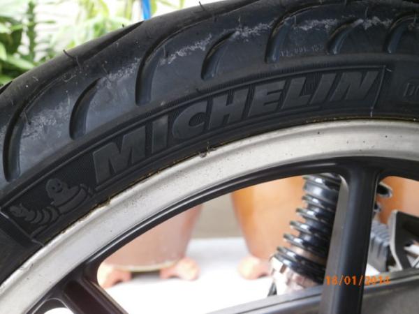

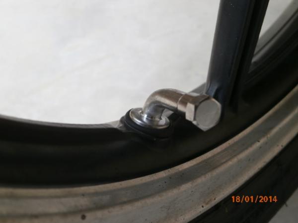

changed tire rear
michelin pilot street
RM110

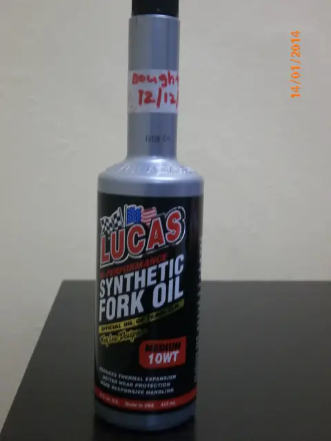

take note guys
fork oils have 4 years shelf life span
so better mark your bottle
also take note of factory packaging date
like mine synthetic fork oil 10W LUCAS was - The product have a code date.. and yes they have a shelf life of about 4 years.. Looking at this code, this one was made in May 8 of 2013..

review
LUCAS synthetic fork oil
10W
after changing to my yamaha spark Z fork
truly amazing
very syok riding feeling

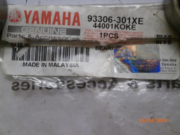

changed
front wheel bearing KOYO both side covered RM24
rear wheel bearing genuine yamaha bearing RM28

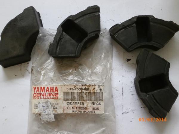

rear wheel genuine yamaha hub damper RM12
applied red grease pennzoil 707L
