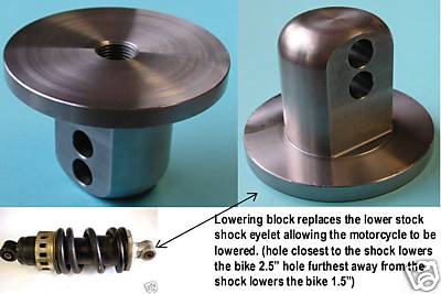

Our adjustable lowering kit replaces a stock part on your bike, and will allow you to adjust the height to fit your riding needs. Our lowering kit will allow you to set the height down 1.5" or 2.5" lower than stock height. (Please note: you will need to compress your shock spring to install this, or any other VLX lowering kit on your shock.
dun have much photos, but i guess it is mounted right at the susp from their descriptions.

okok i know how they mount it liao.. it replaces one end of your suspension mounts... bro.. dun need to lower first... do the subframe like what i told u.. might be able to make it work.

This is the lowering kit I used.
You can DIY it, but you will have to machine it out of a block of metal. In terms of design, it's pretty straight forward. You don't even have to make it nice and round, just make sure you take appropriate measurements.
But what you should be concerned with is structural integrity. This part carries a lot of weight, and will be subjected to a lot of force. If it cracks, your bike will bottom out, and you will crash.
Installing it isn't difficult.
You have to remove the existing shock, compress the spring, unscrew the existing head, and screw the new one in.
Removing the existing shock is quite straight forward, but tedious. You need a range of spanners, a car jack, and a few hours. The Scootwork kit comes with precise instructions, including what spanner sizes you need.
Compressing the spring to access the bolts to remove the head is difficult. Scootwork sells a spring compressor for abt US$30. If not, head down to Braddell Road where David the suspension expert is. I'm not sure if he's still there. I went to a few shops, and only David dared take on the job. The others said no one ever needs to touch Steed rear shocks, so they don't have the right adapter to compress the spring with. David himself had to improvise, but we did it in the end. He charged me $20 for all his effort.
Once you can access the bolts hidden by the spring, it's easy to loosen them to remove the head. You just need the right sized spanners, some oil, and brute force.
Screwing the new head on is easy. Just do everything in the reverse. If you want to lower the steed even more, Scootwork suggests sawing off 1/2 inch of the threaded rod. I didn't do this, but your bike will drop by another 1/2" if you do. Again, the Scootwork instructions cover all this.
After you've taken care of the rear shock, you can reinstall it. It'll take an hr or so. Again, quite tedious, but pretty straight forward.
ic, they hav another adjustable type, but the device looks real simple, probably able to diy?

I ordered this one... Felt that the holes were a bit further apart so the support should be stronger.. The one sold at scootworks looks similar but the holes are a bit nearer, and in theory, the thickness of the metal between the holes looks thinner as well as the base, and therefore, IMO is not as strong...I'm not putting down any of the products but its just my humble opinion... Both using the 1144 stress proof steel anyway but a bit cheaper, especially the postage (USD$10.49 only)...
