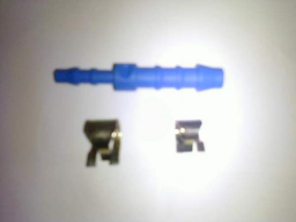

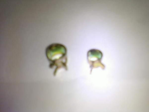

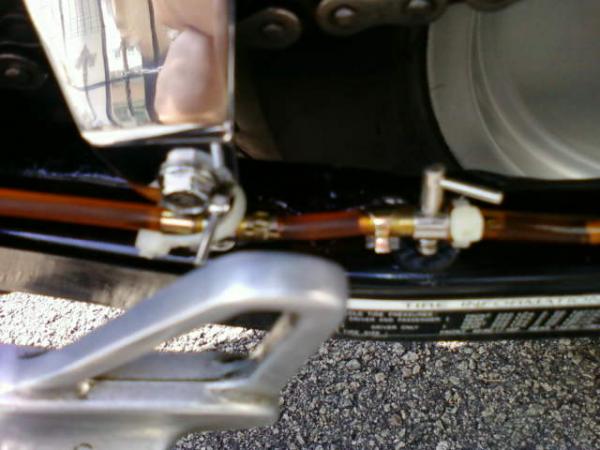

These are the spring clip and hose reducer joint 8mm to 6mm tube found at the below shop
Hup Teck Hardware
Blk 25, Jalan Berseh
01-114
http://www.hupteck.com
cheers
Hup Teck Hardware
01-114
cheers
thank you for the infor..now no more leaking joints...thanks buddy

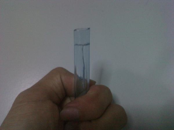

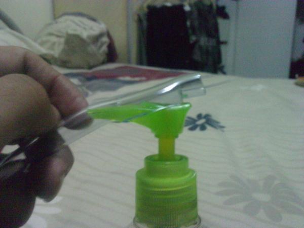

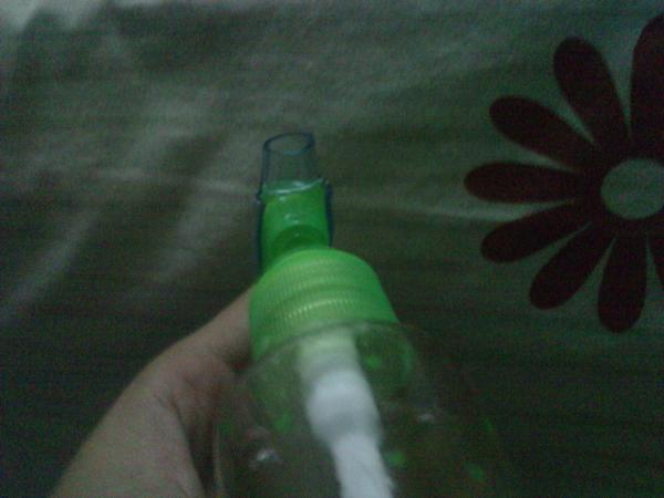

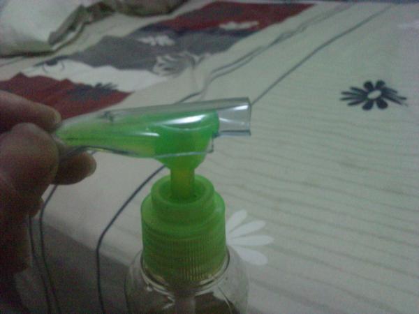

Hi these are the improvement I made to the Oiler from the Clinic the last time.
First the Hose connecting the Bottle to the smaller hose.
I cut a T-shaped slit to make a catch to clip onto the pump's head. :)
Although air should still flow through, I still poked a hole a near the nozzle just in case there is still airlock.
Next I tested it, it was a snug fit, and the whole thing didn't use any glue or cable tie. Neat! :smile:

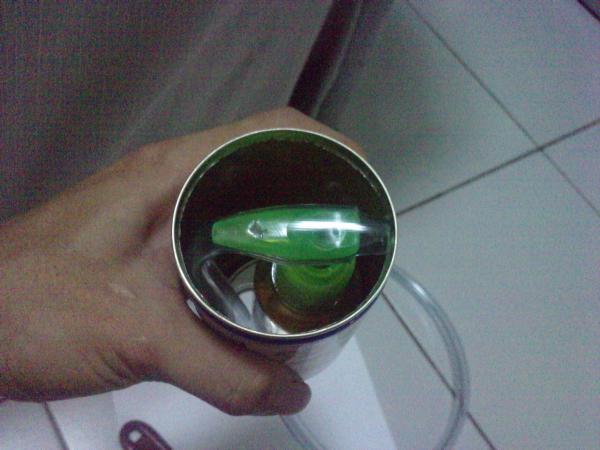

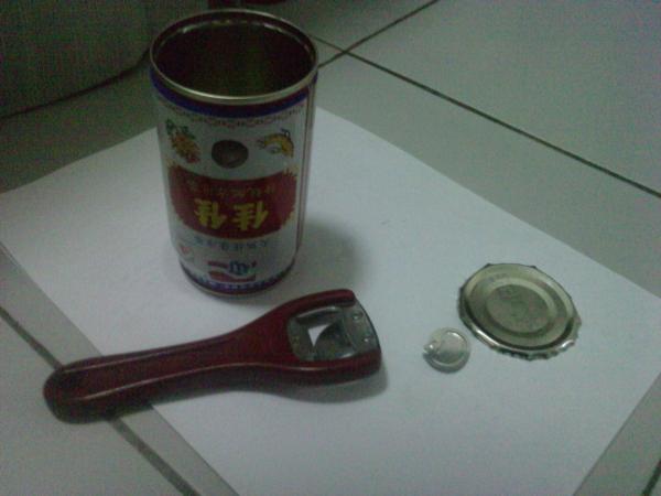

Some people got their bottle cracking, leaking or lossening during the ride, so I figuered that it, since we can't strap the bottle too tight otherwise it will crack or too loose otherwise it will fly off, it better not to strap the bottle at all.
Well not directly anyway. :cheeky:
So I got a Jia Jia Herbal tea drink can and cut the bottom off using a can opener. :D
Then I plucked away the tab inside, and slot the hose through the opening and through the hole for the straw! Then in goes the entire bottle! Yeah! Now I can strap the whole assembly to the Bike without having to worrying about it flying off or cracking under pressure.
I will put a layer of newspaper inside the can for padding and cover the top with a layer of rubber to water proof it before I reattaching it back to my Bike. I will post the rest when I am done. :)
this is neat man...

lets say average ride per day is 20 km..
dose quantity is 1.5ml..
therefore lub oil usage is 30km/ml...ie 30,000km/L
ie you will take 1,500 days to consume 1 L of lub oil...
hahahah that means average rider takes about 4 years to consume 1 L of lub oil...
yeah..if chain can last say 60,000km..it will take 8 years to replace chain..
the cost is 2L of lub oil=$20..plus 3000 doses/pump actions.
wah your $6 oiler really going to save u alot....
2 sets of chians and sprockets..in 8years (average ride /day=20km)
better fuel consumption
better accelaration
less noise/less vibration from chain...smoother ride
and the best thing is that i dont have to break my back to clean it...
wow...it is my bestest investment in the bike...
those who did not install..eat your heart out...woohooo.
..:cheers:

My seal savers...
hahah..see how long this last....
