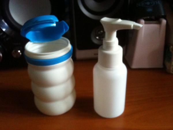

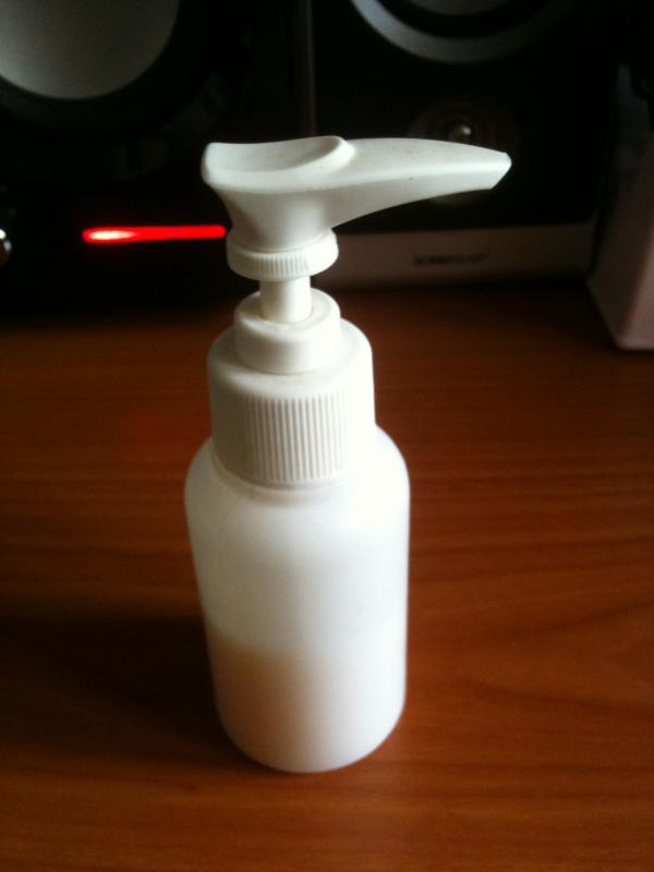

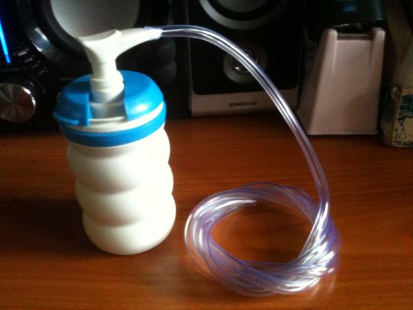

Oh, I've found another bottle to hold the dispenser. I've done some modification to the cap and even drilled holes below the holder to let rain water out! Wad I need is to spray it black before installation. Check it out!
kk.. u got everything.. Now u just need to make a Tip for your oiler..
How? slot a metal wire into the tube ..
check out pictures:

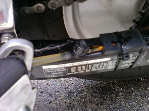

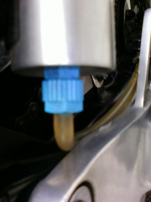

No worries bro, I met up with Joe awhile ago and we shifted the oiler to the left of the bike and we din cut/poke any hole on the upper section of the tube (from bottle to the valve section) so as to slow the flow even more and we think it's better. Joe taken some picture which I think he'll post later. Cheers!
Don't do it to others what you don't want others to do to you! God bless! :cheers:
here r the pics
http://i8.photobucket.com/albums/a20/kmjoe/21022010357.jpg
http://i8.photobucket.com/albums/a20/kmjoe/21022010358.jpg
http://i8.photobucket.com/albums/a20/kmjoe/21022010359.jpg
previously i used jt's method and i found out that the oil were escaping thru the "hole" on the tube which jt had suggested so tt the flow is faster, it really was a mess as it wasn't positioned properly. pat n me made some modification which i feel is alot more simple... 3 brains work better than 2 :cheeky: so this is the result of jt + pat + me
here r the pics

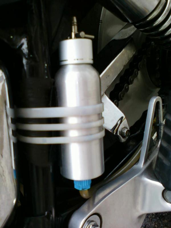

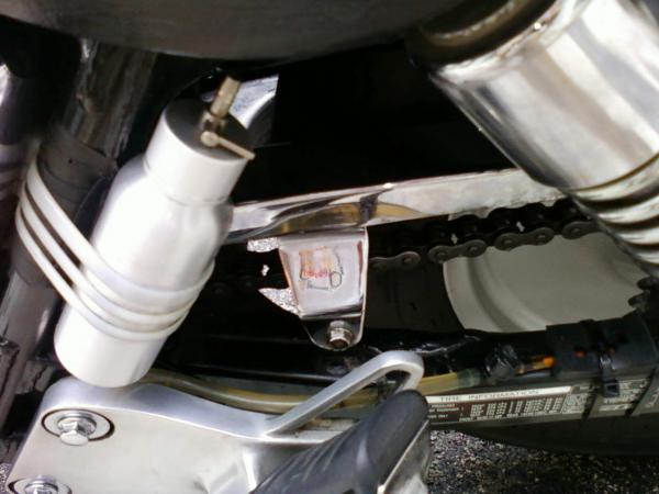

This will stop the flow of oil when the valve at the top cap is closed.
Check this out
wow very nice, mind sharing how u did urs?
Aluminum bottle ( plastic bottle will crack after a while under the weather )- buy from Daiso Plaza Singapura
Union hose stud connector - buy from Lavender MRT shop selling connectors and water hoses
s/s steel air valve - any fish aqua shop
silicon tubes - Boon Keng MRT shop selling rubber and silicon products (near to DBS bank side)
plastic fluid valve(oil will not leak from this valve) - Pasir Ris Farmway fish farm ( selling salt water fishes and water filter products)
a small piece of rubber - cut a grove to secure the tubes.
Cable ties and Velcro tapes. - for vibration shock.
Cap need to drill a small hole to secure the s/s steel valve and a nut to secure.
Bottom of the bottle need to drill a hole to secure the union hose connector stud.
Make use of gravity flow to feed the oil to the tubes once the s/s steel air inlet valve is open.Once the air inlet valve at the top cap is close, a vacuum is created and stop the oil from flowing. The plastic fluid valve to close when parking.
Hope that it help with u oiler
Cheers

God in his wisdom will protect you

Stop valve the breather and block the flow.

well if you clean once a week, it wont not be messy and dirty.
At the same time you control the oiling time with the air inlet valve and no leakage from the valve.
I use to have leakage problem when using the s/s valve at the tube, then it become oily
Cheers :)
