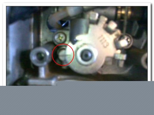

  Movi$tar said:
Thank you everyone for the help so far!
The 2T indicator where im supposed to check for two lines to meet at full throttle position (assuming stock settings) is it this one?
Am i supposed to remove the black rubber cap from here? Coz i seem to be having some difficulty removing that cap. Wont seem to come off unless i maybe try using a lot of force.
http://i865.photobucket.com/albums/ab211/darylegoh/Mobile%20Uploads/IMG_20160316_200512_zps7dmzxnlf.jpg
Nope. Open chain cap, you will see there beside your gear
Sent from my D6653 using Tapatalk
http://www.amague.com/ps/krr.jpg
Managed to find from my archive photo.
Once you open the gear cover, you can see like this
That 2 line must meet each other, then your 2T setting is normal consumption.
if right line is lower than left one, then your 2T consumption is higher than normal.
If higher than your 2T consumption is lower than normal.
Hope this can help.
