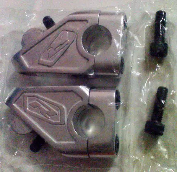

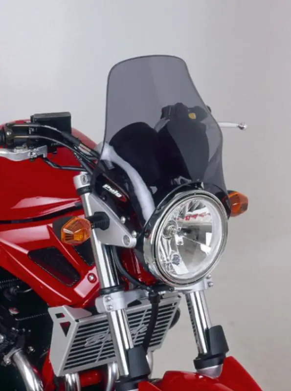

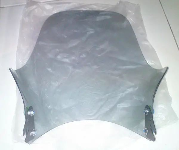

Any one install handle bar riser?? it rise up ard 1' and shifted towards rider ard 1'. Any feedback/review?? i just bought one and found need to change longer brake line too to install the riser.
Also bought a 3rd party windscreen similar to Puig Naked screen. with 2 brackets but no screws. need to find the screws myself.
