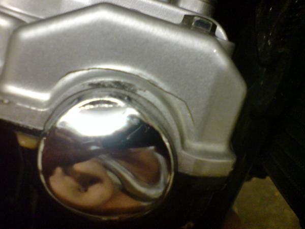

greetings guys. encountered a problem. i think there is engine oil leaking out from this part. attached a picture for reference. what will happen if i dont rectify the problem? if i will to fix it, how much will it cost? did it happen to you guys before? really appreciate your guys helps. cheers.
