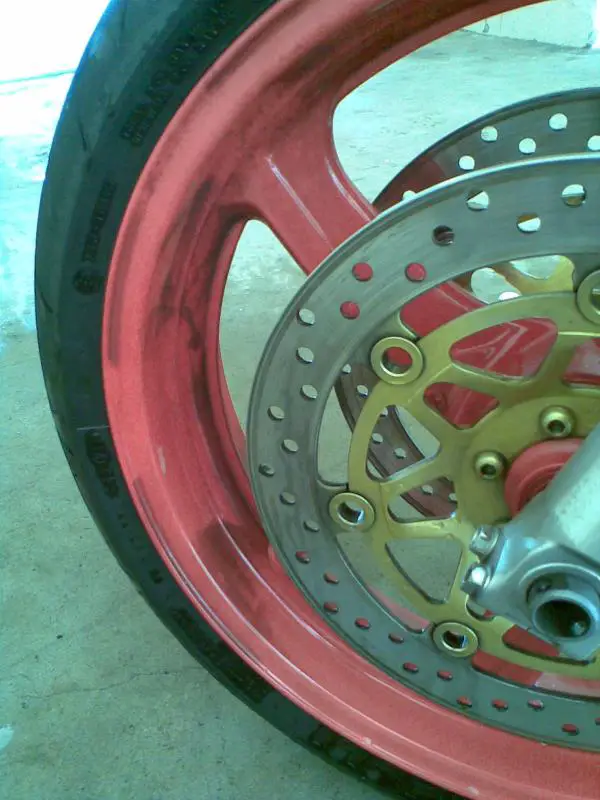

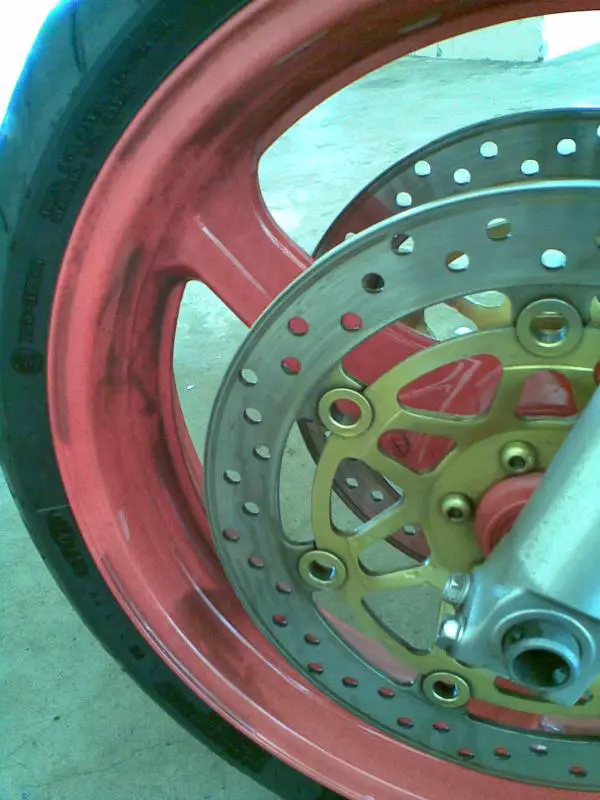

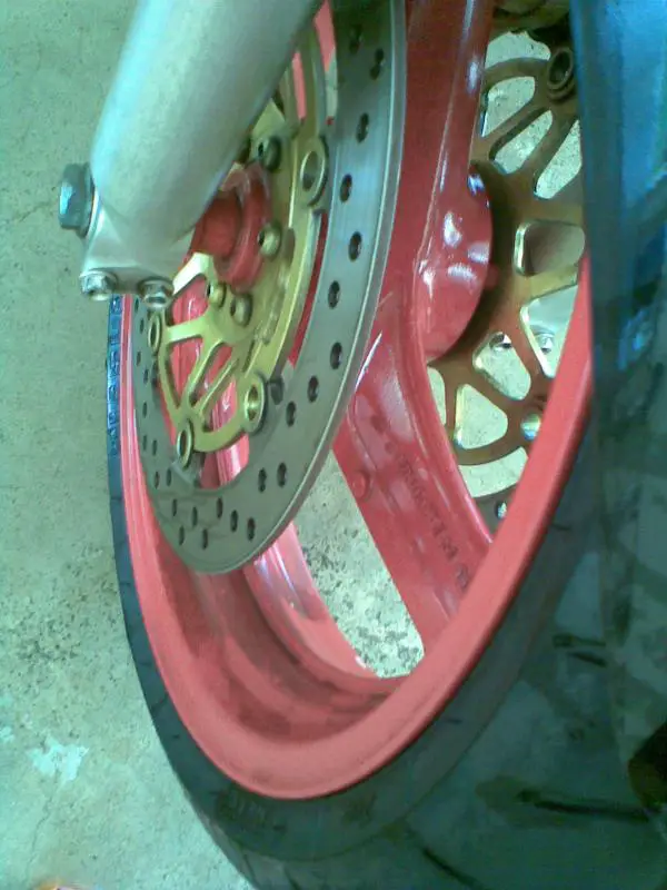

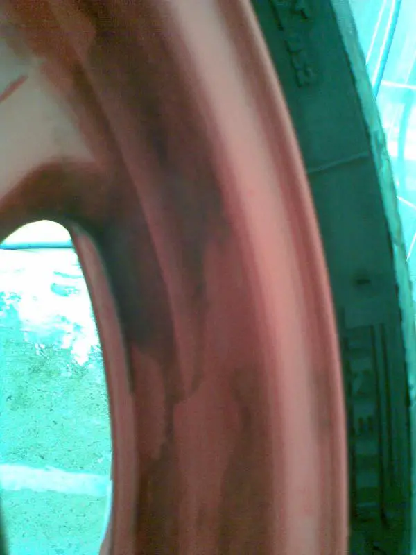

Hey bikers! Any idea how to clean off this stubborn stains on the rim? I spent hours on a rim just to TRY remove it. Im using Black Magic (Wheel Cleaner) and some other product like Mr Muscle.. hahaha.. Kinda no use man.. Below are some pics of the stains on the rim.
y dont u try Jiff?? it works 4 me.. :cool:
http://i847.photobucket.com/albums/ab31/mufarridun/395467_10151281899004118_1083329383_n_zps4299baea.jpg
You Will Bring Me Everywhere I Wanna Go :lovestruck:
looks like dirt and grim stains? i use gt85.. spray and wipe.. less than 15min to get it done..
