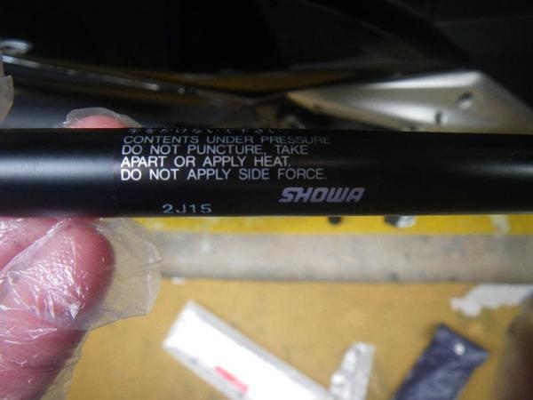

huh? i thought the stick is to hold the seat up???
u mean when i open the seat it will auto rise up if i changed the hydraulic stick???
btw is it easy to diy change myself or i have to bring to mechanic there???

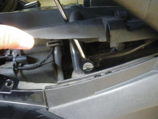

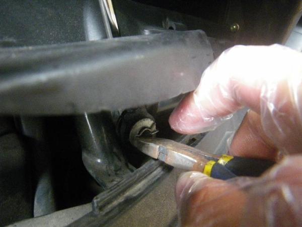

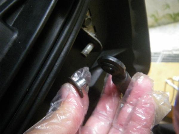

Need to remove this plastic cover and i use elastic band to hold the seat whilst I remove it

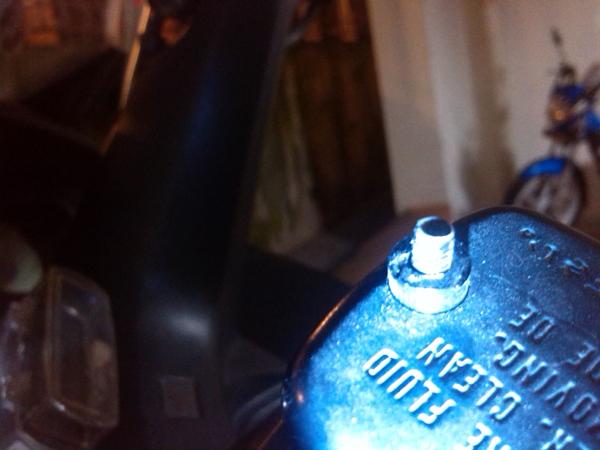

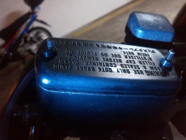

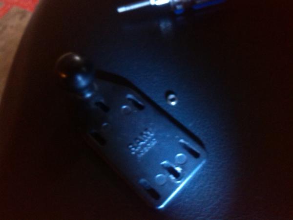

One day before my bike trip and this happen just 2hr ago when Im in JB
The Ram mount / brake reservoir allen key head broke off ...lucky the brake reservoir cover never fly off
No time to go bike shop....think tomolo will try to brute force the remaining screw out.
[ATTACH=CONFIG]294634[/ATTACH][ATTACH=CONFIG]294635[/ATTACH][ATTACH=CONFIG]294636[/ATTACH][ATTACH=CONFIG]294637[/ATTACH]
excellent post... I put to Tech Corner can?
Grade A mechanic
very hygenice
got wear gloves one
:clap:

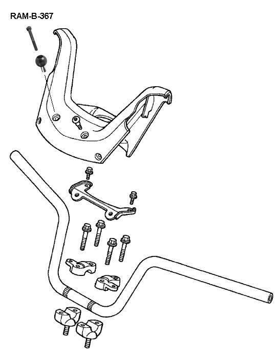

prob a matter of personal preference, i think the on handlebar or handlebar top cover RAM solutions are safer, cos even if the screws break, doesn't harm the bike's braking ability.
My 1st Choice = On-Handlebar
Shown mounted on left of SW's handlebar so that still can do some "poking" while on the go :p
http://i692.photobucket.com/albums/vv287/josephsbs/Silverwing/RAMside1.jpg
My 2nd Choice = At centre above handlebar top cover, mounted onto bracket for top cover
Shown using RAM's RAM-B-238 (single ball diamond) that requires 2-screw mounting.
Actually, the better solution is to use RAM's B-367 1-Ball solution (see attached).
http://i692.photobucket.com/albums/vv287/josephsbs/Silverwing/RAMcentre.jpg

Thanks for the input scooby:cool:
THink I will go for the first choice too.
I need the ram mount with combo x grip closer to my face so I dun need to look down
and away from the road as with 2nd choice.
Also need it to be on my left side so Mrs Nighthawk can peep into it and sometime help
poke the Gps whilst I keep on riding...we change course all the time :lol:
