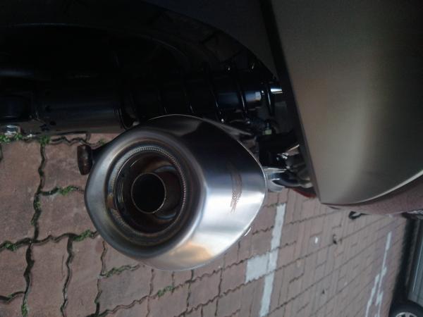

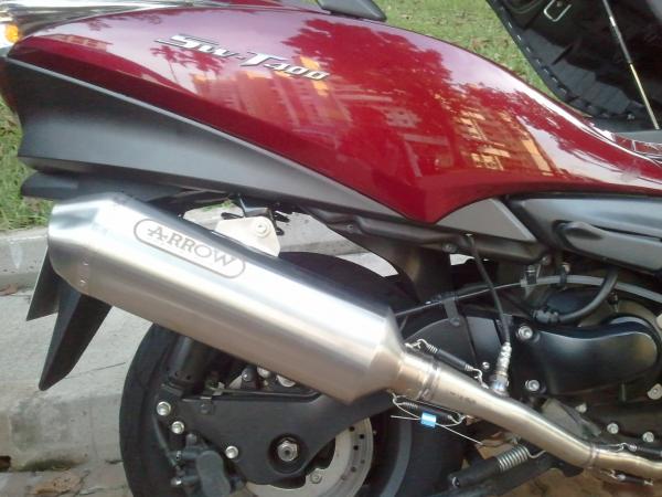

QUOTE=CBR_1000;8231127]Where can i view this sale? Anywhere or shops where i can see and hear the pipe sound?
That would be mine. Pipe is with my mech. for a small token you can have it installed and ride around to have a feel. Sadly i do not have a video of the exhaust sound. sms 81114867 to discuss.
2012-04-20 18.29.53[1].jpg 2012-04-20 18.30.36[1].jpg[
