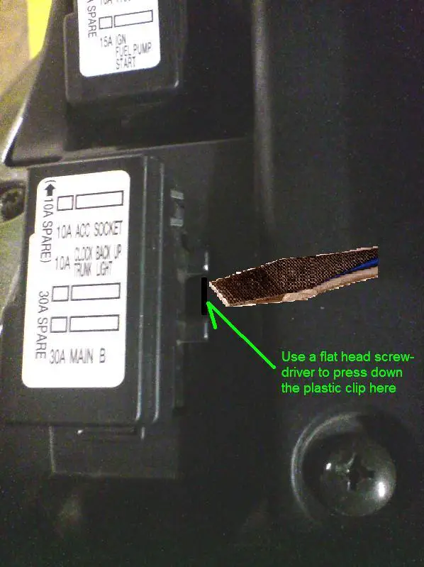

Just now I adjusted the air screws. Tried to remove the black plastic cover to have better view of air screws but can't, is it must remove the 2 fuse boxes, how ah?
So in the end, i just access the screws thru the hole in the plastic.

There are 4 screws holding the plastic.
Dislodge the fuse boxes with a screw driver. Just push down at the clip that is holding it.
The one near the back can slide to the side of the plastic.
The one near the front can slip through the hole that it is located.
The sides of the plastic cover is held under the fairings, so must push it out from under.

I have removed the 4 screws. i dun really understand how to dislodge the fuse boxes. At their sides, they seem to be attached to the black plastic cover right? Do i have to open the covers of the boxes to slide to side of plastic (rear) and slip thru the hole (front)?
yes, the fuse boxes are hooked onto the black cover so that they could be kept in place while on the move
no, the hooks are on the side with clip holders to prevent them from slipping out. look closely and you'll find a small plastic level in the small gap. use a flat head screwdriver and depress it gently, then you can pull the fuse boxes upwards slowly. see attached pic for location of level
Thanks guys for the help. Managed to detach the fuse boxes and take out plastic cover. The scoobydoo's pic really help alot and sw9000's explanation now makes alot of sense to me.
