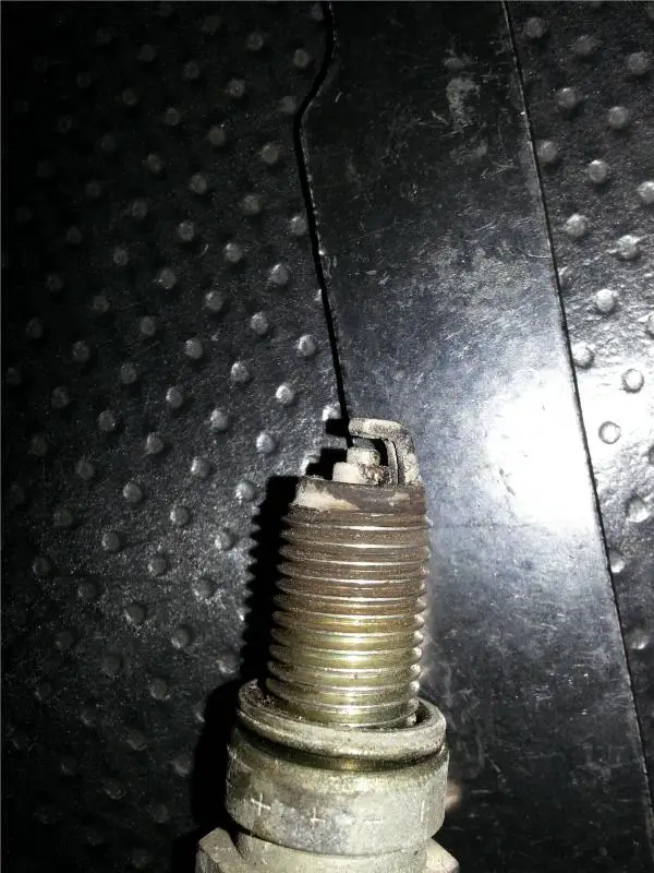

Hi guys,
i've 3 questions on my mind not sure if anyone can answer:
1. Recently i've removed my spark plug to check to see what was the problem behind losing power, and i found that the one corner of the spark plug insulator was burnt off and some of the white stuff even got on the bent part of the electrode.

can someone comment on whether is due to an over lean condition or improper gapping of my spark plug before installation?

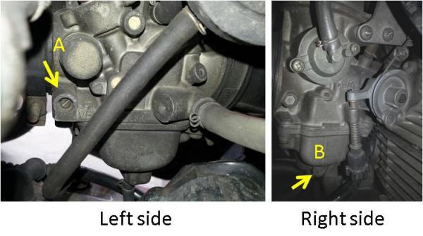

2. which is the air fuel mixture screw i should adjust below, A or B?
i've been trying to adjust screw A to adjust my carb.
3. i've been adjusting screw A (as referenced above in question 2) and it decreases in idling when i turn it clockwise and increases in idling when i turn it anticlockwise, either way from the original setting.

Hi does anyone has an answer to my previous post below?
Hi guys,
[ATTACH=CONFIG]268510[/ATTACH]
[ATTACH=CONFIG]268511[/ATTACH]
does this original setting means that it was too lean or too rich? if it was too rich, does the damage on spark plug make sense?
thanks in advance for giving your opinions on this!!
