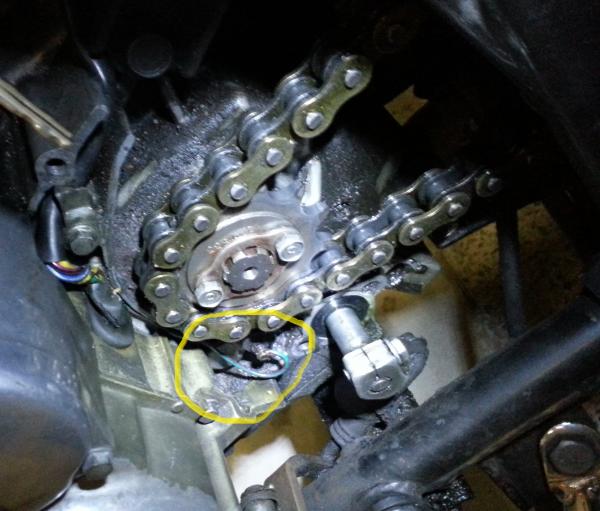

erm, has anyone faced an issue where your bike is in neutral but the starter motor wont crank unless you clutch in?
it's a random on off issue for me.
also, does anyone know where the clutch switch diode is located on the ta200? =X
i dont tink its the clutch switch. could be ur neutral sensor. is ur green neutral light always on? if its the issue, thats why u have to clutch in. cux mine went bonkers one day and had to clutch in to start. opened up the sprocket cover and saw the wire to the sensor was dangling. connected it back and all was well.
nope, my neutral light operates normally and i always check that i stop in neutral. despite so i still hv to clutch in randomly sometimes.
i opened up my sprocket cover and found 2 wired areas.
is this the one you are referring to? it was connected though the wire looked a lil pinched.
anyway i found two diodes.. they were hidden behind the left chrome cover opposite the rectifer! i didnt test cos there were 2 .. probably only when i have more time -_-
operate a vehicle in a way that you benefit other road users pls - and meanwhile, stop whining! be responsible and be safe.
Yeah thats the one. Then could be ur clutch switch or maybe some connection somewhere. I also found the wire harness thr but nv knw wat they were for. LOL. But wen i got the bike, my IU was tapped from there.
lol i think ill just see how and check the diodes later once i buy a new multimeter to test continuity loh.
i also wiped up that wired metal ring that was hooking on to the neutral switch... maybe too much bitumen from the chain affecting the conductivity..
so far its all good for the moment so hopefully its all fine after that!

Yah last tym i also just spray contact cleaner on that sensor once in awhile. No issues after that. That area gets rly dirty frm chain lube all.
contact cleaner is a good idea! think ill spam IPA on that area!
