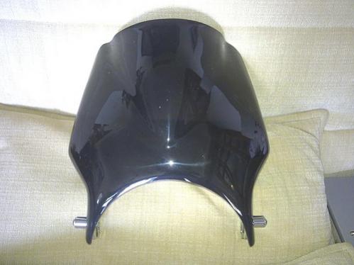

Hi guys, just wondering how useful is a windshield against wind blast while riding? i'm doing some researching for windshield for spec3 and here's what i found. Anyone has any recommendation for any windshield that they are using?
GIVI 240A
http://www.singaporebikes.com/forums/attachment.php?attachmentid=269934&d=1360213744
PUIG 4620H
http://www.singaporebikes.com/forums/attachment.php?attachmentid=269933&d=1360212817
PUIG 1482H
http://www.singaporebikes.com/forums/attachment.php?attachmentid=269932&d=1360212816
Face Mask
http://www.singaporebikes.com/forums/attachment.php?attachmentid=269930&d=1360212813
