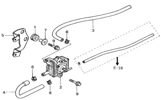

Backfiring could also be due to this part - Air Suction Valve. Cost around $65 to $80 to replace. But Gen 1 seemed to be very affected by this problem. My old Gen 1 changed once and was ok for a while, then it came back again.

Air suction v/v as mentioned by matthias is also possible, but since you mention there's a lag in throttle response, u may wan to check if ur carb need to service also.
