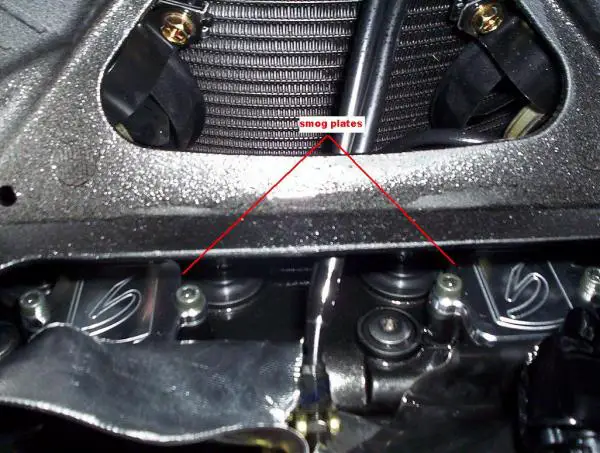

hi guys, here is some info on the benefits of using the smog block off plates on just about every model motorcycle. Hope can explain it.
If you have something to add please feel free.
From the factory most motorcycles will come with a pair valve system on them. This is basically an air pump that pulls fresh air from your air box, sends it through a bunch of hoses, and then pumps that fresh air into your exhaust ports on your cylinder head.
There is unburned fuel that makes it through the combustion stroke, exits the cylinder head, and makes its way down the exhaust system to finally exit into the atmosphere. The pair valve system adds fresh Oxygen to the exhaust so that as the unburned fuel comes into contact with the extremely hot catalytic converter, the additional fresh air will aerate the fuel for a more efficient burn and keep the exhaust cooler. This equals less emissions being released into the atmosphere and lower emission readings when tested. Here are some of the main reasons you should consider installing the smog block off kit on your motorcycle.
(1) The pair valve system really requires a catalytic converter to complete its job of burning off excess fuel. Once you have installed a full race system and have removed the cat, all this fresh air will do is mix with the unburned fuel vapors and beginning to burn up while exiting the exhaust. This create the popping and back firing that throws those incredibly cool but damaging flames out of your exhaust. Great for night riding, but terrible for tail sections and leg hairs. To eliminate this add the smog block off plates.
(2) If you decide to have your bike dyno tuned then you cannot run the pair valve system because as it adds oxygen to the exhaust gases. This causes dyno sniffer (reads the air/fuel mixture exiting the motor) to pick up false A/F readings due to the additional Oxygen that is added after combustion. When it reads the extra O2 it thinks the bike is running lean and will compensate by adding fuel to the fuel map. Now you have a map that is much fat (too much fuel) and the bike will run terrible. The person that is tuning the bike will have to pinch these off every time you dyno the bike. To eliminate this add the smog block off plates.
(3) The tubes, pump, and wires that are included in the pair valve smog system add unnecessary clutter and weight to the motorcycle. To eliminate this add the smog block off plates.
(4) lastly but not mainly, next time you change the plug will be more easy.
If i'm wrong feel free to add comment
Have a safe ride.......

oh.. how is the plate being install? do we have to remove the engine and install it?? or??
It is at the left and right side of your fairings.
The pic is after i installed it.
The best is ask bike shop to get it done for you,
cos it took hrs to get it done.

what if i install this plate but no PC?
http://sphotos.ak.fbcdn.net/hphotos-ak-snc4/hs605.snc4/58582_425759858089_606683089_4979174_1311643_n.jpg
hi,
No problem, you can install it without a pc.

hi,
would it still help ?
It still help...not to worry about it.
Sorry bro but to ask u again , if i just install the plate nia no PC , it improve in ?? don really understand :cheeky:
well to put it simple .... this will help to pull in more air to make your bike run smoother as more air that mix with the correct amount of petrol will reduces backfire for full system and reduces weight :cool:
that means your bike's response will be increase also
What say u :angel:
