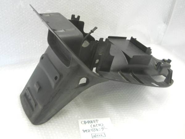

Anyone got old ver S / pb1 rear fender for sale pls...?
If not anyone know which scrap yard I could go to find?
Thx!!
If i never remember correctly, vers and PB1 comes as a whole stock tailboard. Unlike spec 3 where fender is a separated part.

Hi bro, actually is not.. I just took mine apart (fender cracked)
the top part (rear fairing) and the bottom part (fender) is actually 2 pieces...
Fender looks like this:
