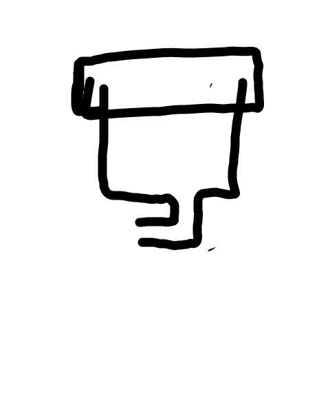

my reservoir got 90deg bend. outlet part also 90deg. Ur reservoir is downwards.1344931688026.jpg

my reservoir got 90deg bend. outlet part also 90deg. Ur reservoir is downwards.[ATTACH=CONFIG]254210[/ATTACH]

For your case, you might need to use a improvise bracket. Bikeshop should be able to do that. Mine reservoir is also straight downwards hence I never use brakcet at all. The rubber hose itself is holding on the reservoir.
As for the reservoir volume, there are roughly 2 size available (I think), 1 big and 1 small. The smaller one by right is for the rear brake where the brake fluid volume is lesser where else the front should use the big one where the brake fluid volume is more.
The reservoir mainly is to always ensure there is always brake fluid inside the brake system during hot (expand) or cold (contract)operation. So if you use the small reservoir at the front, there is a chances of insufficent brake fluid or overflow of brake fluid, I think...
Anyway enough of my BS, I'm using small reservoir for my front. No issue so far. The only problem is during bleeding. You will need to constantly pour brake fluid into the reservoir to prevent the reservoir from drying up. But let the bikeshop worry about this...
