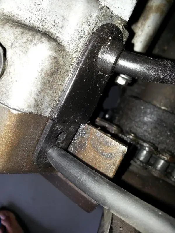

Can somebody pls advise if this is normal?
(This is the left side of the engine, somewhere under the carb)
I changed water pump oil seal, and I still have water seeping into the engine, making my EO cloudy..
Sent from my GT-N7105 using Tapatalk 2
Long Live the Dream.
[ATTACH=CONFIG]282928[/ATTACH]
looks ok as your chain is there.. thus it will flick the water/chain lube towards that direction.
EO cloudy would need more pictures and information.. :)
