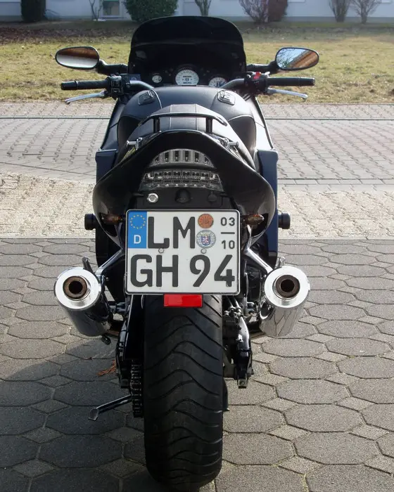

Also for those who are keen to upgrade their rear brake light look, i have to upgrade their rear brake light look, i have seen in a japanese personal blog that one guy took the Honda 954RR rear tail-light (LED) and installed it to his BB. Needs some trimming off towards the end of his rear cowl to accomodate the different sizes of tail-lights. Looks good, will try to provide picture when i find it again. :thumb:
The LED light is nice...
Wondering weather any s'pore shop have it..
http://www.motorradonline.de/2002bilder/cbr1200xx.jpg
Seems like have to cover up the difference in space at the bottom of the rear light just above the licence plate/ reflector. I asked K& T to order a sample in for me and stock have arrived, have not checked with them abt the price. No time now cos busy with work.
This is a sample picture.
