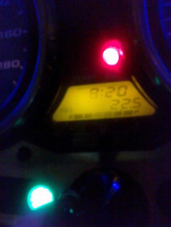

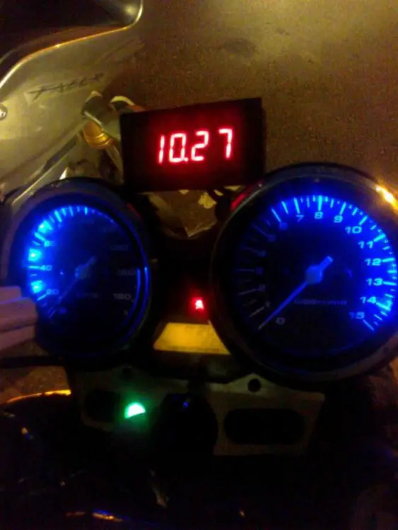

Hi guys... im jus helping out a friend whom tried to DIY his meter.. as per attached are the pictures.. are you guys oso have the same problem? and i do notice when u remove the strip, its thicker.. but the calculator strip is thinner..
http://img.tapatalk.com/d/13/07/11/syvevape.jpg
in the day...
http://img.tapatalk.com/d/13/07/11/ujaza3u5.jpg
at night..
so need your review on this.. thanks
