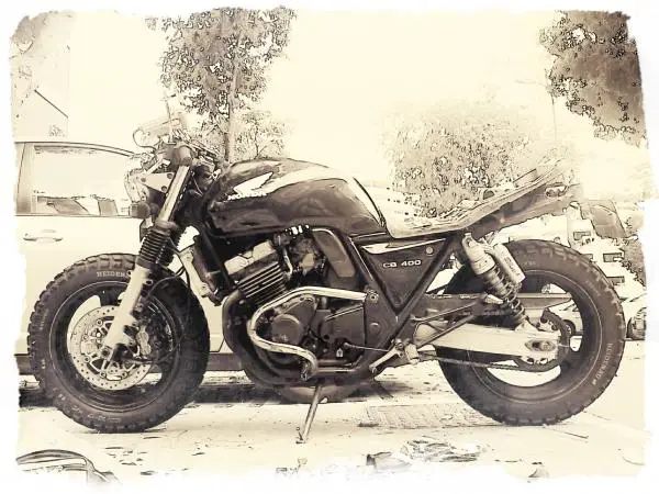

So I just finished my seat yesterday. And fixed on my Biltwell grips.
Now need to figure out a less conspicuous position for my IU.. thinking of putting it under the headlight behind the number plate. but looks like it will barely clear. any other suggestions besides the cliched next to engine position?
I have received lots of questions on the bike, so i'll just summarize it here.
The seat was measured and cut to shape from the original s4 seat using just pliers and a bread knife to cut the sponge and lots of time.
Picture of the bike with just the S4 seatpan sans sponge
I then sent it to an upholstery shop to wrap it up with the design i had in mind. i believe any shop can do the seat wrap. I used the original S4 seat so that i can retain the utility of the underseat storage using the original seat locking mechanism.
Clip ons are available at ahboy.
Forks were lowered.
headlamp grille was 7" Mini headlight stone guard bought off eBay
biltwell grips were bought off eBay
Tyres are Heidenau Scouts. Sprockets and chain were changed to accomodate the fat heavy tyres.
Paintwork was diy with rubber paint as a basecoat
Taillight is LED lamps bought off eBay.
Forkboots are from Triumph motorcycles.
No frames were harmed in the process of the modifications so that i could reassemble all the original parts again for the annual inspection.
(yes time-consuming, but i love spending time with my bikes)

Hi bro I'm STILL doing my s4 project. Can I ask how'd the tyre change affect FC?
it went down drastically in the initial stages (from 25kpl to ~19kpl) but somehow it increased and stabilized. currently i'm getting between 23-25kpl.
