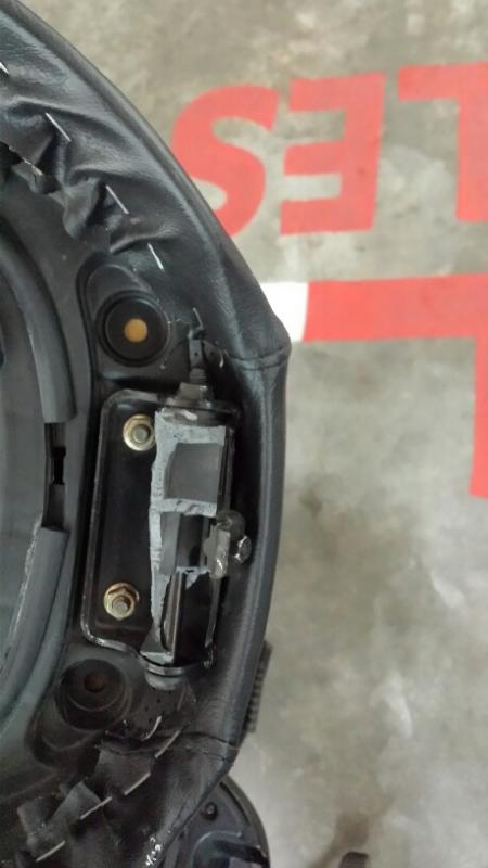

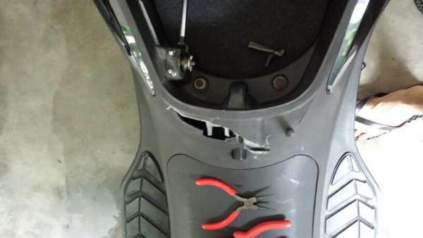

Looks as if it snapped because of a great deal of force....but then, might have just been brittle....
I think it should be wear and tear. I start to notice the seat tend to slump one side for the past few weeks. I thought it was due to some loose screw until it snapped today. Maybe it just happen I got a bad batch.
suddenly I remember sending my scooter in for changing the seat leather. Maybe those guys did something rough? just a guess...
