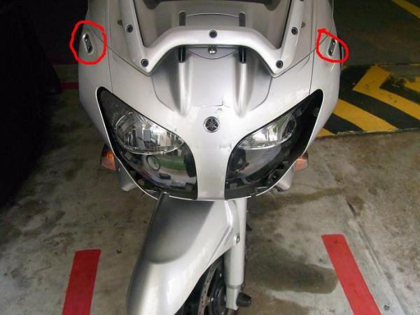

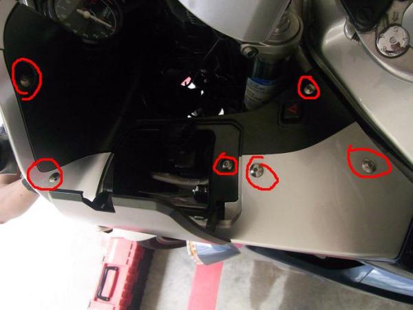

Firstly, take out all the screws u can see on the dashboard..dont forget the right side screws..
i guess this is pretty basic..
If u peek at the side ur secret compartment(5), slowly unscrew the 2 quick release screw..
Once done, the left & right dashboard can be pull out safely.
Next unscrew the 2 nuts for ur mirrors(6).

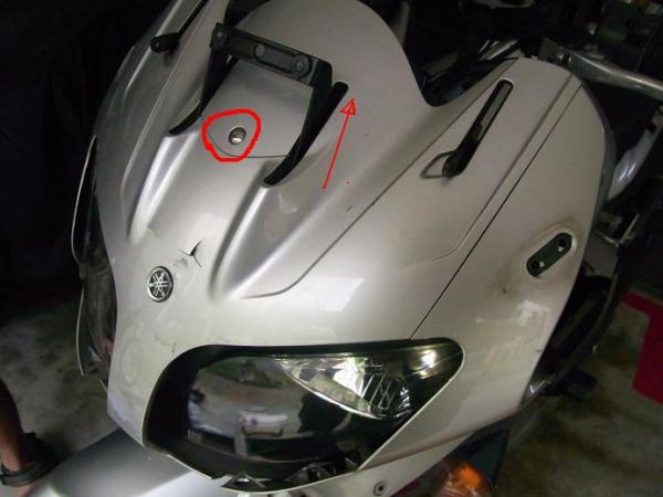

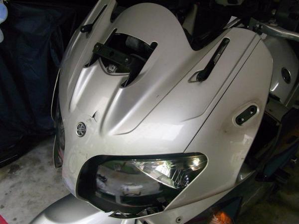

The next thing will be the windshield..
As mine is Gen1, i just need to unscrew 7philips screws..

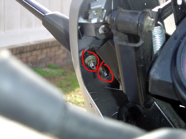

Now we are left with 2 screws on the bracket(9).

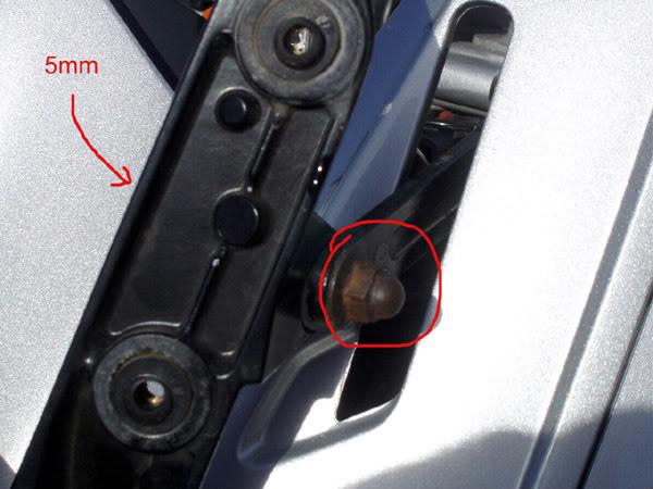

Then u need to hold the 5mm hex screw n unscrew the nut(10).

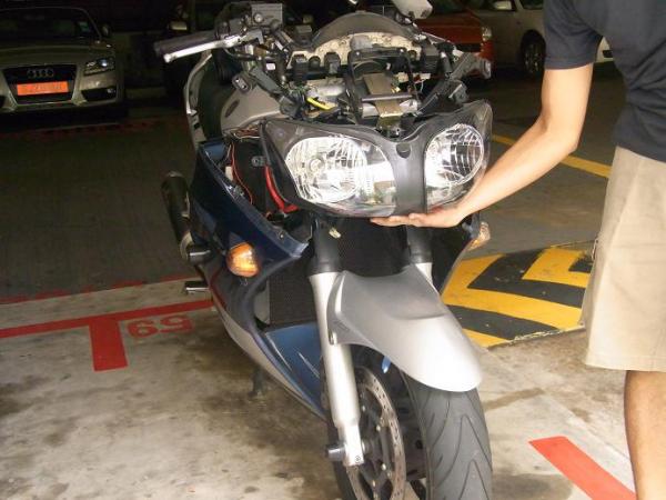

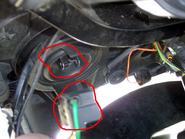

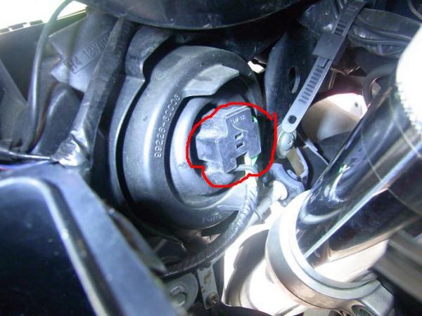

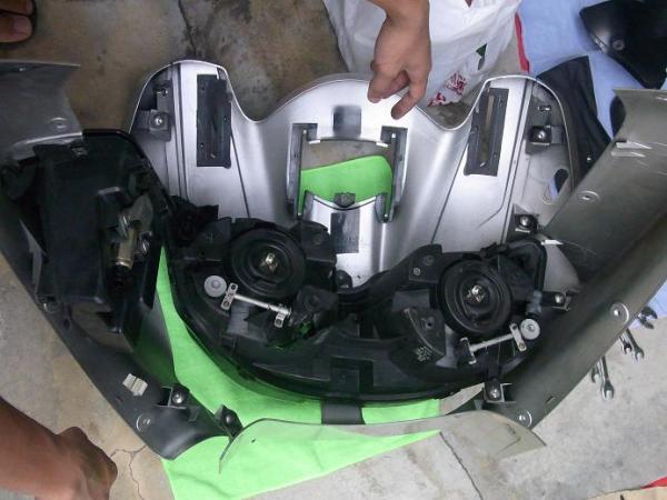

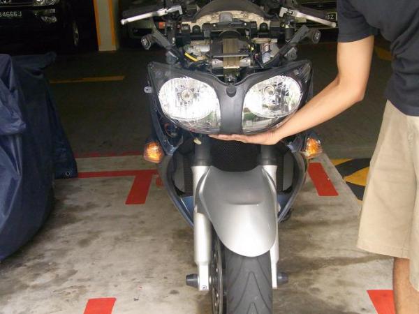

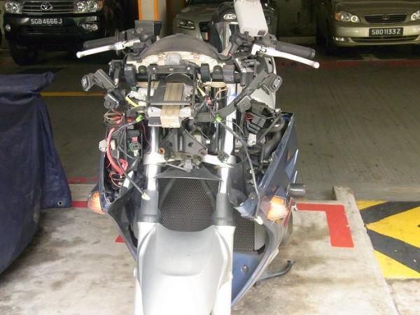

Now, disconnect the headlight wirings(there's 4, 2main & 2mini-15/16)

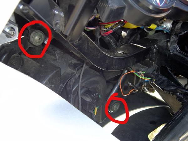

Ure are now left with 4 more philip screw b4 the cowling is out..
check for 2 philip screws on each side behind the speedometer(17)..
unscrew them..

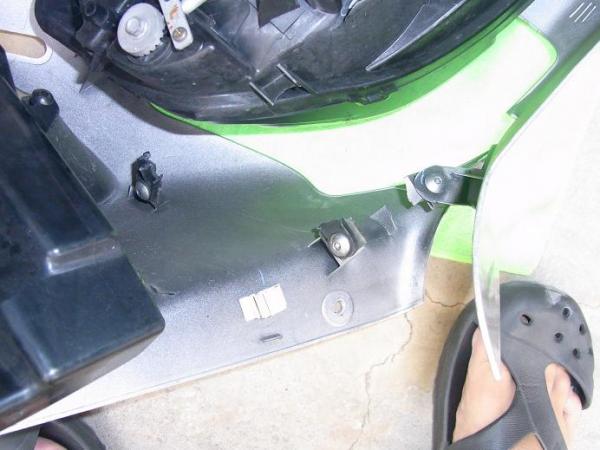

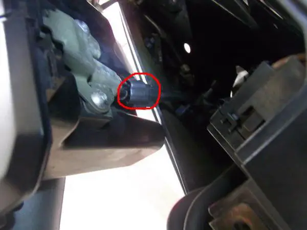

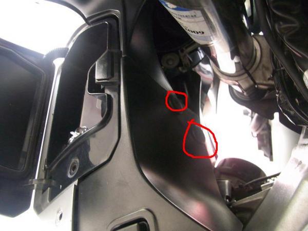

u still can't pull the cowling..check for the safety connection at ur secret compartment..release the catch(18).
Now the whole front cowling can be out...

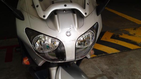

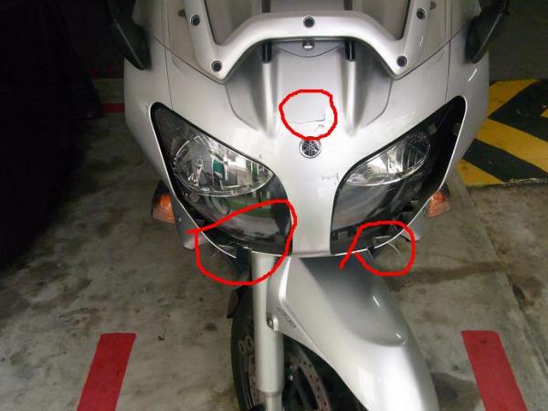

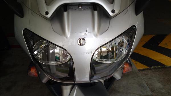

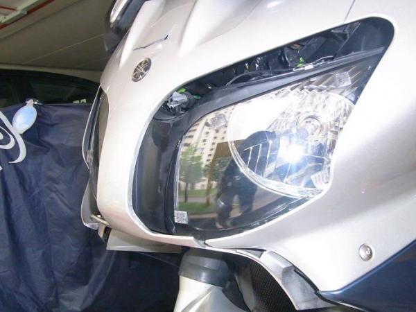

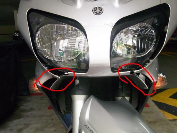

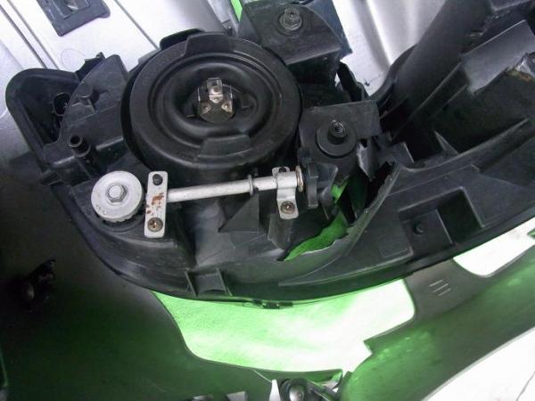

some damages done to the headlight..
canvas bike n got home to complete some glueing. on cowling..
n proceed to AM to buy a new headlight($330).

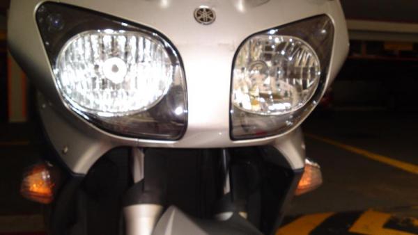

Den start to assemble slowly..
Installation just follow the the steps backwards..
if still cant fix..don't call me..hahhah
