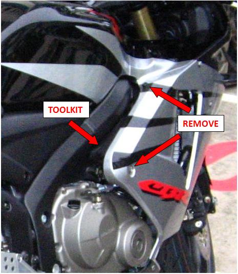

yes its a tight fit to latch the helmet directly to the hook without the supplied helmet cable. but it still works i suppose.
and u dont need to go servicing to remove the toolkit, coz u dont actually have to remove the fairing. u just need to remove the top small black plastic clip and the big bolt (see image below), then gently pull the fairing out abit to reveal the black compartment with the keyhole. quite easily done.
thanks alot. come with pictures which was handy. i'll take a closer look over the weekend.
