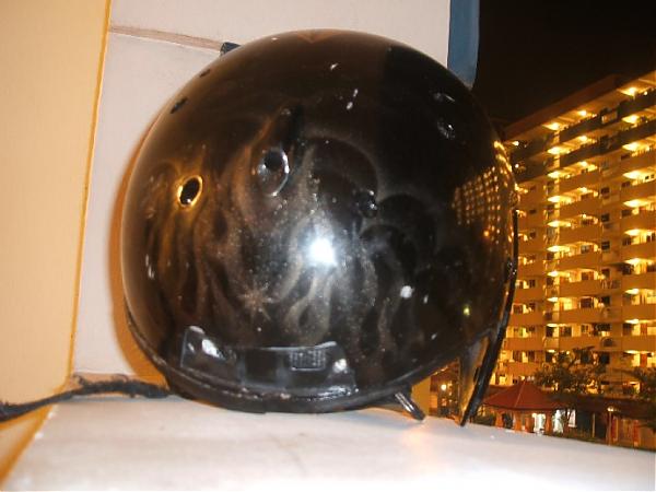

kirkjay, how do u actually go about doing the flames design?
wah..i got post 3 kinds of flames here. you'd better refer which flame design you want to know hehe...

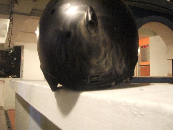

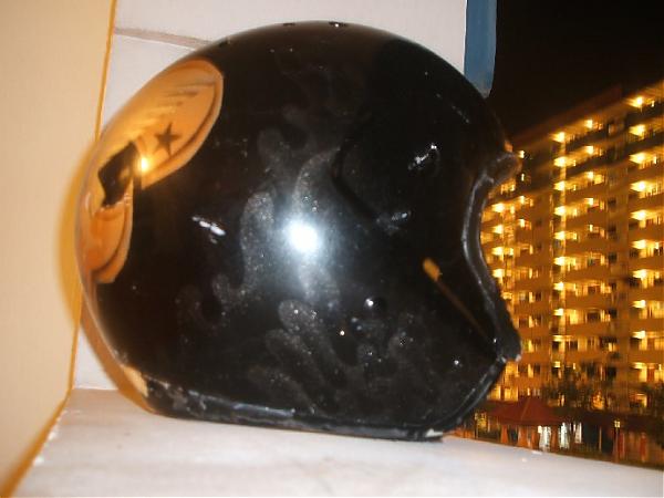

on the black helmet i free hand using a french curve which i cut out in a transparency sheet.
but both are very different flames. the 1st one was an unsucessful true fire. the other one is called a overlapping ghost flames.
the one on the blue helmet is a also a ghost flame abit to heavy on the colour with drop shaddows which gives the flame a 3D effect.

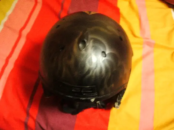

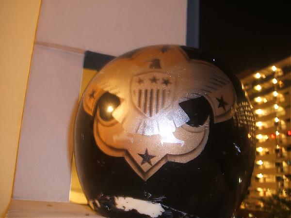

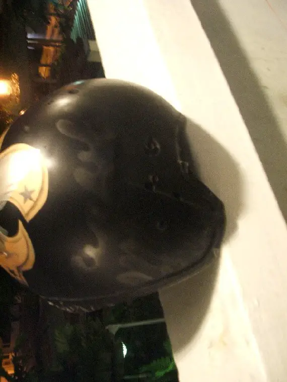

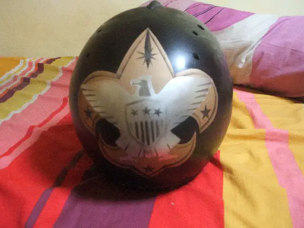

any way guys..i threw away the eagle scouts helmet liao... count take it as the stupid foam wouldnt come out.. and the rubber...

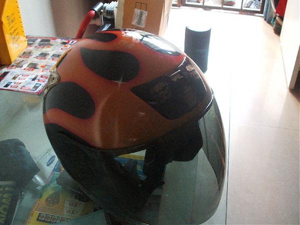

the pics below were given to the rider which coincidentally is taking out a CBR1000 repsol with the orange and black paintwork...

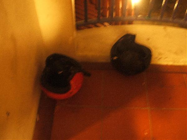

oh yah..1st when to sand the black with rubbing compound then clean it and let it dry which took 1 hour plus drying 3 hours..
after that prep work took 2 hours...
then spraying the orange took 10mins...
drying...1 hour...
then airbrushing the blend...1/2hour..
haha..preparing takes even longer than spraying the bloddy design... but 1st lets see the thrashed helmet...but nice paint work....being thrown away...

lets throw the helmets on the pavement..
oh yah..i already clear coat the helmet...but it had some runs..which could be sanded down...but i wanted to take out the the foam...which did not come out...after which i threw it away..

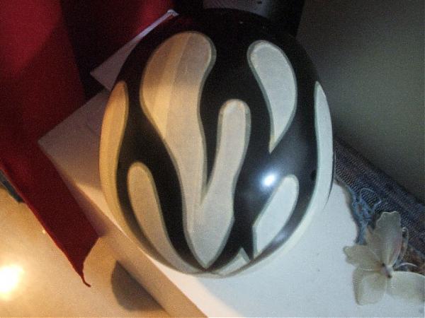

this flame design has a specific name to it...
just to name the flame designs i have knowledge on...
overlapping flames..
hot rod flames...
steel flame...
tube flame...
ghost flames..
emboss flames..
prinstripe flames...
tribal flames...(yes tribals designs are actually sub category of flames..)
and the most difficult and most impressive are..
true fire...(costly)
which very few airbrush artist locally and across the causeway can do...
flames are named with usually with the color 1st then the category which can be compined with another category...

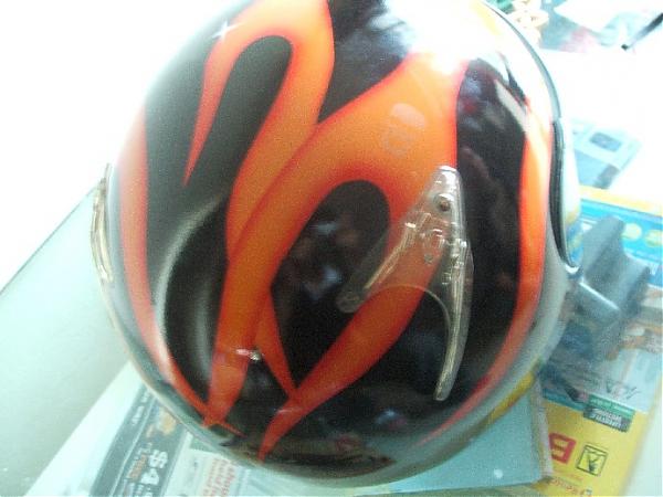

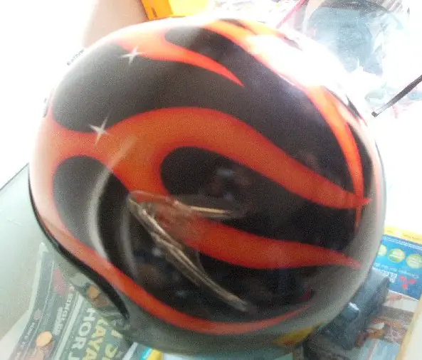

decided to prank the owner which is a friend of mine...
told him i sent it to the shop.. as i couldnt do it....
then he got pissed of with me for 20 secs before i told him the truth...
i call this a hotrod overlapping flame...
if you look closely in the helmet...
me and the owner of the helmets sillohete are reflecting in the helmet at a some angles...
comfused....Clear coat is a success...
