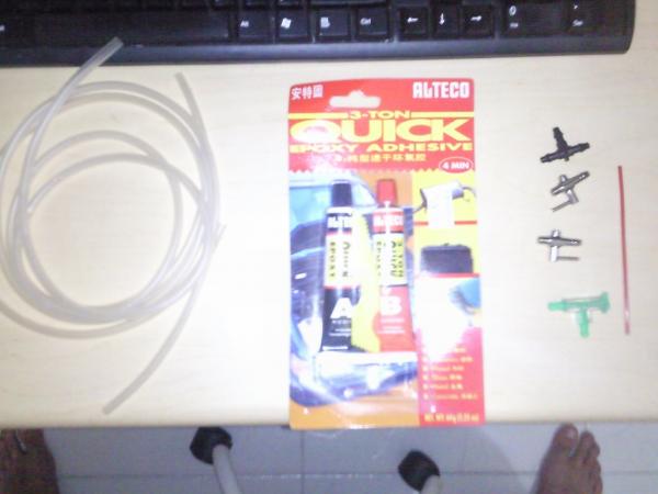

Hi.. i buy a few things for the DIY set up.. try a lot of time but keep fail.. can any1 help me... dun mind travel to ur place to learn.. can help me c i buy the correct thing or did i miss out few for thing..
Thanks
Edited by vemon
Bikes
30 Nov 06 to 17 Dec 07 - Honda SP FT2676K
17 Dec 07 to 21 Oct 09 - Honda CB400s spec1 FU4977Z
21 Oct 09 to 26 Jun 10 - Yamaha Fazer FZ6 S2 FBD8658E
26 Jun 10 to 22 Nov 2011 - Yamaha FJR 1300ABS FZ3450G
29 Dec 10 to 26 Nov 2011 - Yamaha Fino FBC5429A
26 Nov 2011 to 08 Mar 2013 - Honda Silverwing FBB5520Z
08 Mar 2013 - Yamaha Tmax
Thanks
u miss out the cable tie, bottle and 1.5mm cable.
2000-Yamaha lc125/2001yamaha tzr125/2002Suzuki gsxr400r/2003-Honda TA 200/2005-Honda wave S 125/2005-Honda S4 spec 2/2007-yamaha yp400/2008-yamaha R6/2009-Honda CG 125/2010-Suzuki Dr200se/2010-Honda steed 400/2011-honda cb400sf pb1/2011-sym joyride 200/2012-honda wave
cant find any small enough bottle so now try using a small fruit tree fresh bottle(250ml) but thinkin of using 2nd hand pump reservoir(if can find), cable tie have but still finding 1.5mm cable at home.
did a test run using bottle and stick a connector at the bottom using epoxy but still got leak..
ask around many shop to find nuts for the valve but dun have the side..
:sian:
:sian:
go bike shop
look into the screw box,alot of many screw and nut u can find.thread might not be 100% same but comfirm can lock the valve at least 2-3 turn.
i never use epoxy i just use a small rubber washer between the bottle and nut(inside the bottle).

go bike shop
ok... i will try again.. izit ok that i pm u if encounter any problem again..:cheeky:

bro tonychan... how's ur flow rate like?

90sec-2min per small drip.
using the valve to control.timing can be adjust.
diy still can use.just live with the cheap stuff:thumb:
