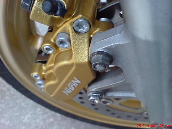

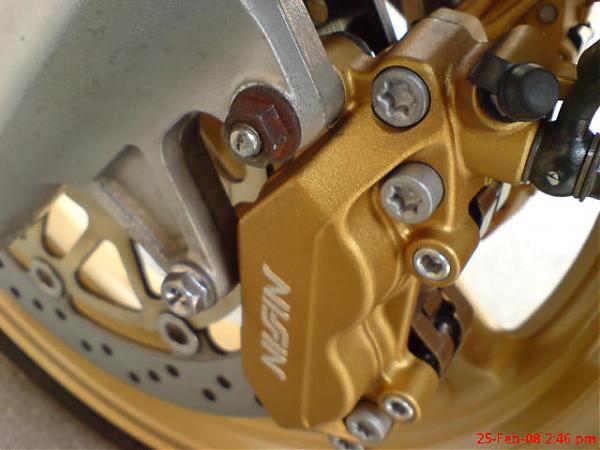

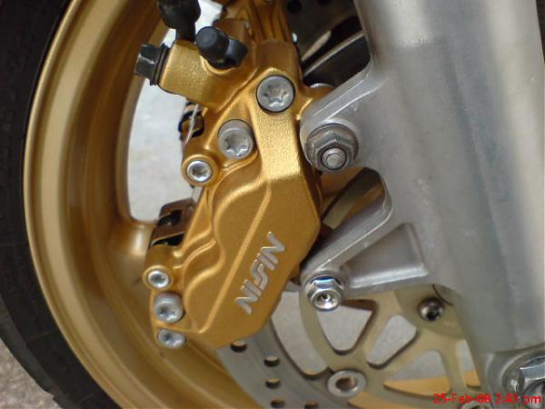

Hi all S4 Bro ...
As promise to post up picture of the way of how i install my new pair of brake calipers.. Click on the link below to view ...
As you can see, there are 2screw securing my brake caliper to the fork.. The below screw is the normal/orginial of screwing in the bolt but the upper one is different ... U notice that the screw is different .. The mechanic take out my whole front tyre and find a longer screw and a nut (cannot use back orginial one cos too short liao).
Then he screw in the screw from inside and tighten using the nut... Den put back the tyre.. In this way, if anyone try to steal, he is able to unscrew the nut but when he try to push out the screw, the screw will hit my disc brake and unable to take out my caliper... Unless, he jack up my bike and take out my whole tyre den i nth to say liao ..:cry:
Hope those pics and explaination will help all Bros riding S4 one.. Seriously go bike shop spend abt $20 like that and get it done in this way unless you wan to be me like that, brake caliper kana steal liao den do this way.. I doubt anyone here would wan that to happen rite ? :p
But till now in forum or anywhere i cant find a way to prevent my rear brake caliper to be done in this way or any way to prevent it from kana steal ?? Anyone S4 bro here have any idea/suggestion ??

bro, wea u done this n how much?? coz i juz called up a bike shop nearest to my place, they like not sure whether tis can b done anot... :dot:

Hi bro, another way is to get Tamperproof Screws. Those like hex shape but got 1 pin in the middle. or even star shape with pin in the middle.

crave,why is it that u only did the top bolt? why not both?(top & bottom)

Any bike shop can be done one .. U juz explain to them that u wan it in this way and tell them that tyre muz take out so that screw can screw in from inwards... I that day do is $40 cos muz do bleeding for my brake calipers cos my front brake reserviour is totally empty liao .. If i not wrong $20 like that should be able to do it liao ...
Also why i only screw the top screw inwards is cos the mechanic tell mi is veri troublesome or maybe more difficult to screw in the bottom fr inwards cos i tell him nvm, top screw can liao ... If you wan i thk it should not be a problem to screw in the bottom one fr inwards also ...

Bro Crave thanks for the photos I be heading down to my mechanic and get the bolts done as what u've explain. Can't really afford to lose my brakes...
