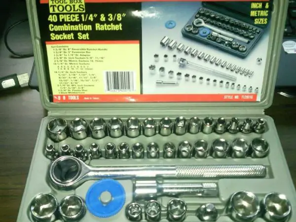

I need to open my spark plugs but don't have the proper tool.
Can I use the wrench socket set to open the the spark plugs..
The left spark plug is easy to access and can use the wrench but the right one is deep inside so need that long tube like wrench.
those tools all cannot, u need a tube like wrench, can go um borrow/steal, i have 1 if u're able to meet me.
diy shop sell those also, i think $4? useful if u're changing spark urself n not rely on um.
Any kind soul out there can lend me?? :pity:
My bike does not come w the tool set ..:cry:
If need to buy, normal hardware shop got sell?:confused:
the left spark plug is not as deep as the right one
you can go to any hardware store and ask for a size 16 deep socket
they will know what is it
the socket can get at autobacs with 2 sizes,16 and 22,with the T wrench at about $6 or $8 i can't remember
keke i just bot the tube only, need something rigid to turn, i use the screw driver in my bajaj tool. imo, it's much easier to carry n keep than the T wrench.
Accident can happen anytime, anywhere.
However ask yourself, do you want to fall at 120km/h or 60km/h?
no need T wrench also can
can use rachet also
but i think need a 1/2" drive one

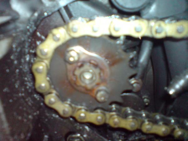

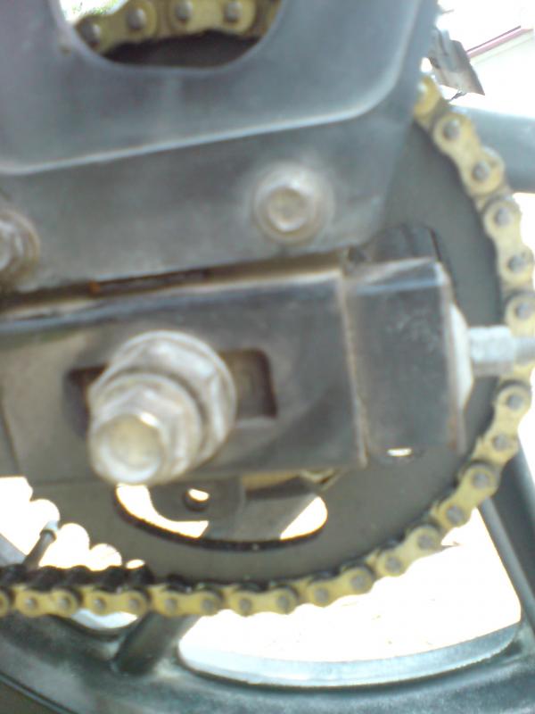

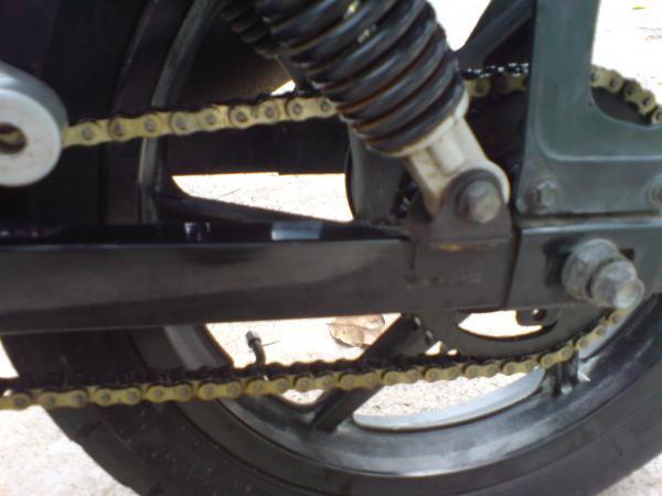

I was able to remove the clip from the chain but couldn't remove the link. So I just put the clip back and left it as it is.
BTW, here's the pics of the chain and sprocket. The rear sprocket looks like stock. The chain is EK 428 SRO O-Ring chain.
http://www.motorcycle-atv-chains.com/site/898526/product/ek428sro
The more I listen to the sound the more it appears to be coming from the engine block.
you might find it easier to remove the link when you pull the chain links closer. a bit of wire helps. or a supple hand, with palm and last two fingers grabbing one end, and thumb, index and rim fingers grabbing the other.
if it is coming from the lower engine, and its specific to the fifth gear, then i suggest you ask yourself for how long you wish to ride this bike. the repairs will be costly.
