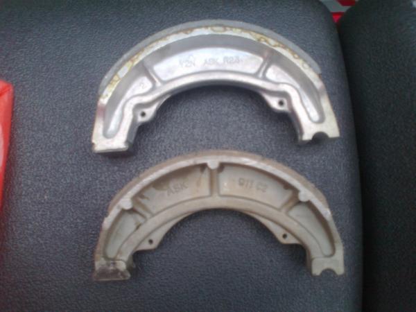

get this as option Front brake pad .. ahboy selling $18 while Heng motor selling $20-$25
Rear Brake shoe .. now not sure where can get this (bright grey/silver) japan made ASK brand
stock same brand made in India (darker grey) .. dats all
